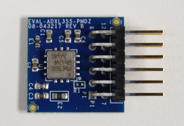

Hi everyone, I want to connect ADXL355 accelerometer sensor with stm32F407 mcu using I2C but, there is no any response from the sensor. Can anyone help me? Thanks...

Tesla DeLorean
Guru
December 14, 2020
Make sure you have pull-ups on the SCL/SDA pins (external 2K7 suggested), and they are configured in open-drain.
Not going to dig into the code. The device needs to respond to its Slave Address with a NACK, or none of the rest will matter.
The Slave Address in ST terms with be (0x1D << 1) or (0x53 << 1) for the secondary.
MHass.2
MHass.2Author
December 14, 2020
in datasheet of ADXL355 it says that
ASEL (pin) = 0, device address = 0x1D
ASEL (pin) = 1, device address = 0x53
why we shift it left?
Tesla DeLorean
Guru
December 14, 2020
Because the address bits are the high order 7-bits, and this is how ST manages them.
If you've not shifted them, and it's not working, should tell you something about the implementation.
