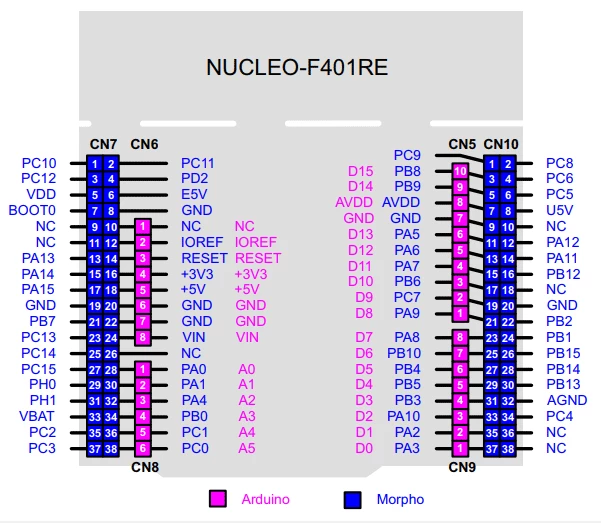

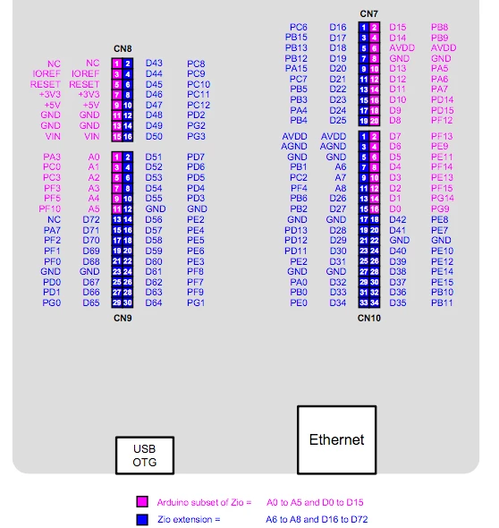

Hello, Is it possible to connect the AMICAM1 with the nucleo H745ZI-Q(Nucleo144) ? If yes, How ? Thanks a lot for the response, Best regards
JWu.12
JWu.12Best answer
Visitor II
November 11, 2021
Hi, the X-Nucleo expansion boards like the AMICAM1 or the IKS01A3 are compatible with the Arduino R3 connector, that is both on stm32 Nucleo 64 and 144 boards. Check the purple connections here below, above which you can plug the various X-Nucleo expansion boards.
  •  STM32 Nucleo-64
  •  STM32 Nucleo-144
