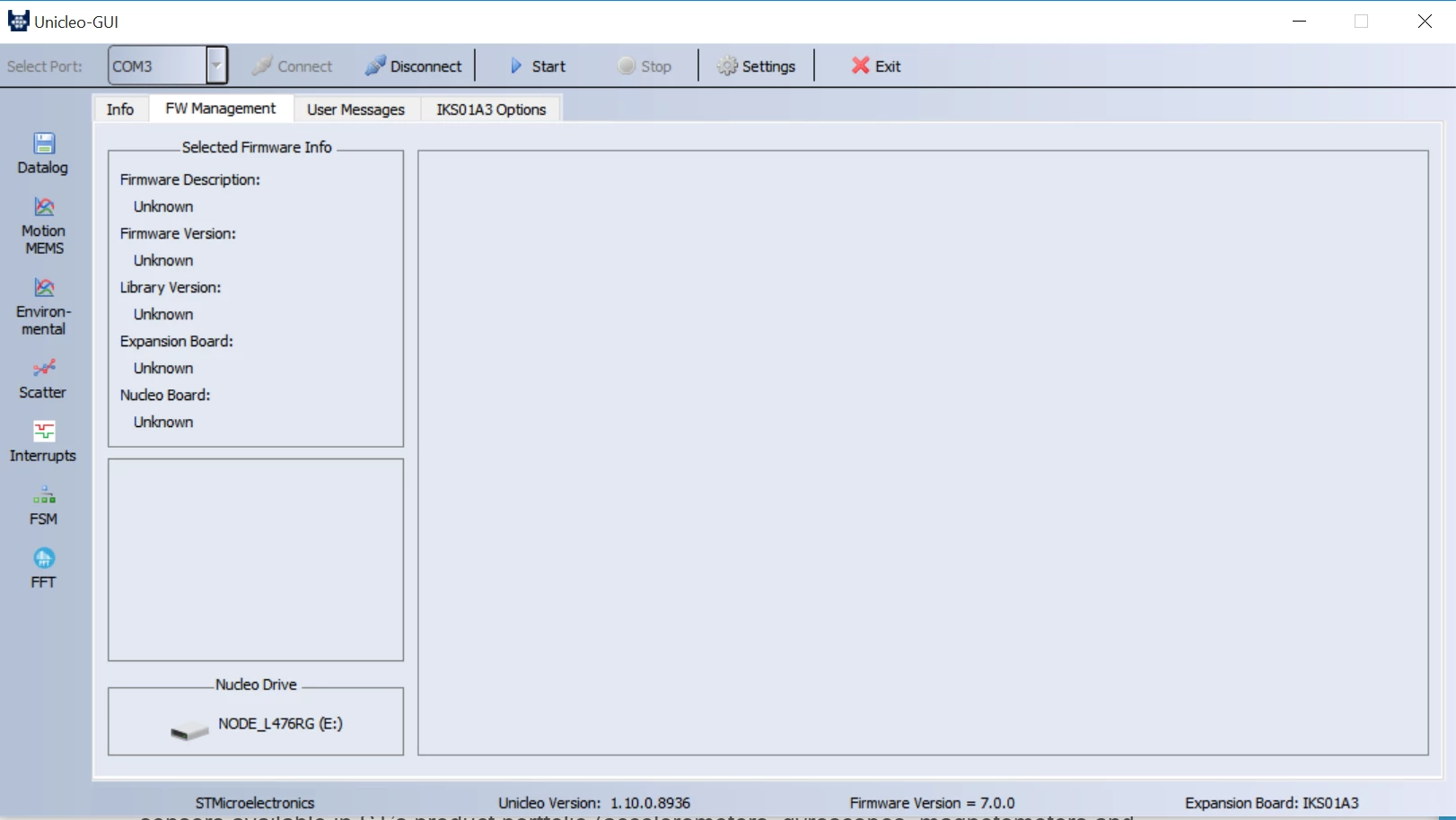

hello,I am working with X-NUCLEO IKS01A3 sensor on my nucleo L467RG borad but I can't find motion libraries on FW management on unicleo gui I need help please.

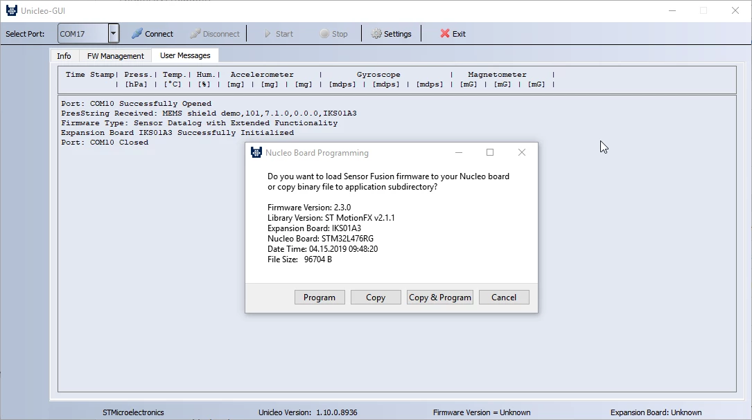

In the \Firmware\Projects\STM32L476RG-Nucleo\Applications\IKS01A3\ you can find project for each library. You can find already compiled binary file in Binary directory. This binary can copied to drive associated with your Nucleo board in File Explorer and it will program the Nucleo board.
Or you can drag and drop the binary file to Unicleo application and it will offer you several options what to do.
Mel f.2167
November 5, 2019
I draged and droped the binary file of iks0a3 from mems1 into L476RG board but i don't find anything in fw management
November 5, 2019
Drag and drop the binary file to Unicleo application.

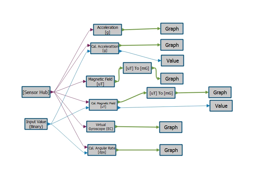

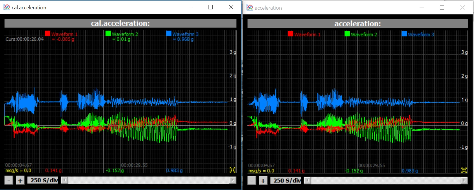

hello,I'am using X Nucleo IKS01A3 and working on algobuilder . when I finish the function blocks and see the graphs on GUI unicleo I get the same graphs for both calibrated and non calibrated accelerometer and gyroscope and magnetometer can you help to find the right blocks for calibration?0690X00000DXQD4QAP.png0690X00000DXQCkQAP.png
