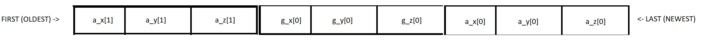

Hello! I am currently working with an LSM6DS0 IMU (3D accelerometer + 3D gyroscope), and I would like to use the embedded FIFO in Continuous mode. I have a question regarding the sequence of the samples in the FIFO and what is the proper way to read

As far as I can understand from the datasheet, the FIFO is shared and there is no guarantee in the sequence of the samples. For instance, accelerometer and gyroscope samples can be interleaved (e.g. first 2 samples are 3-axial accelerometer measurements and then the 3rd sample is a 3-axial gyroscope measurement e.t.c.). Without knowing the exact sequence how can I read data from FIFO? Does the MEMS sensor know that when I read for example from the OUT_X_G it should shift the oldest gyro measurement to the data register so I can read it out? (I suppose not because if the gyro and accel measurements are interleaved in the FIFO how it can keep track of where it is?).

    My concern is the following. Because there is only one common FIFO for both the accelerometer and the gyroscope, the samples inside the FIFO could be interleaved right? For example, the FIFO could look like this:
    0693W00000LwTrdQAF.pngAs you can see in the picture above, first we have an accelerometer sample, then a gyroscope one and then a second accelerometer one.
    For convenience, let's assume that FIFO has only these 3 samples, therefore:
    My question is if I issue a multi-byte read command to the OUT_X_G register like the following:
    i2c_burst_read(data->i2c_master, config->i2c_slave_addr, LSM6DS0_REG_OUT_X_L_G, buf, 6); // 3 axes, 16bit values therefore 6 bytes
    Will the device be able to pop the g_x[0], g_y[0], g_z[0] gyroscope sample from the FIFO, although it's not the first one and transmit it to my microcontroller? In addition what happens with the first sample which is an accelerometer one?
    From the datasheet it is not clear, how the samples are popped from the FIFO and pushed to the respective registers in order to be transmitted.
