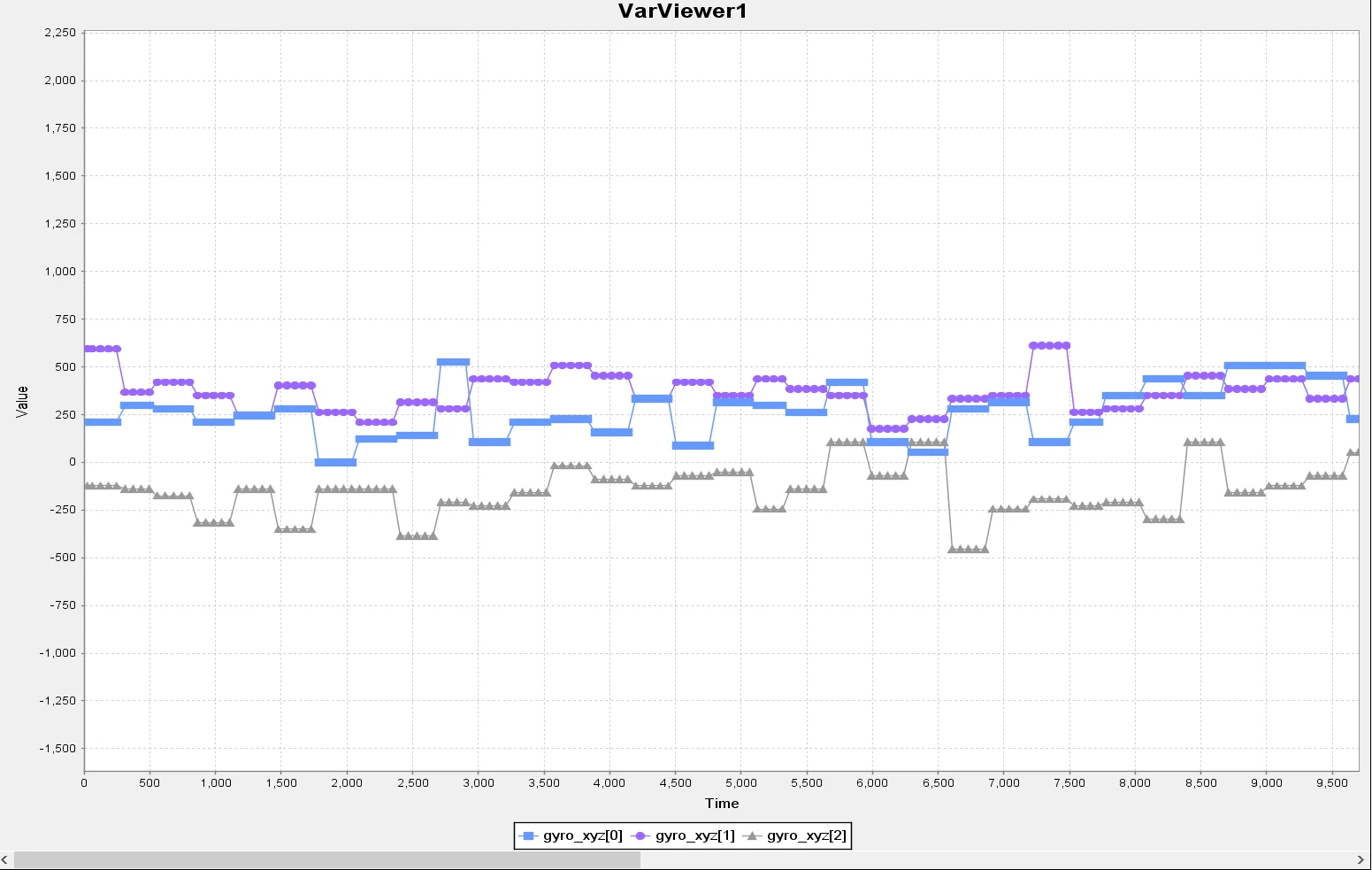

Hello everyone! I try to read gyro raw data from l3gd20 embedded the the stm32f3discovery board. However, the data is quite wierd, they don't approach to 0 at all. Can anyone tell me what is the problem?

PS: below is the curve of gyro data.0693W00000LvnjYQAR.png

Ok, I figure out myself.
GyroX = raw sensor data * sensitivity (mdps/LSB or mdps/digit), here the unit of GyroX is mdps, so the result above looks reasonable. Though, the gyro data still has some drifts sometimes.
