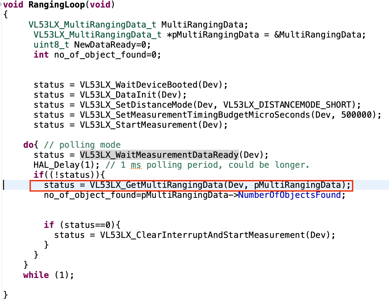

Hello everyone! I am trying to read distance sensor data from an VL53L3 using a STM32G0. After implementing the API code for the conversion the programmed stopped working saying this: Program received signal SIGTRAP, Trace/breakpoint trap.

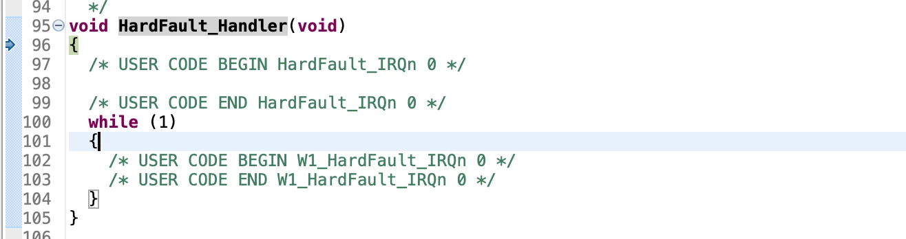

after the function below the CPU goes into interrupt (void HardFault_Handler(void)).

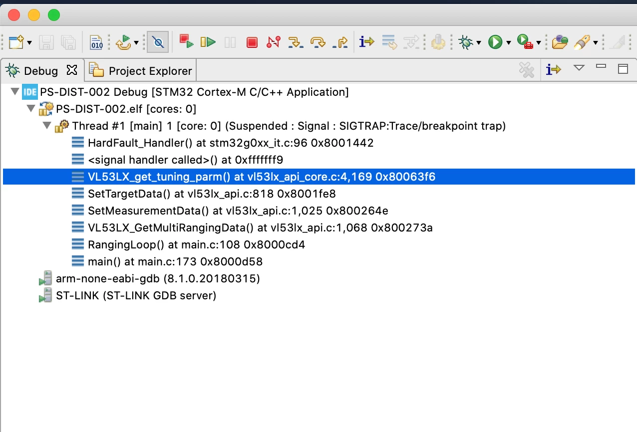

0693W000005C8TyQAK.pngBelow we can see the sequence that leads to the interrupt.
0693W000005C8XvQAK.pngCan you help me ?

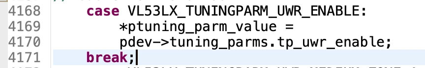

the problem takes place in the file "VL53Lx_api_core.c"0693W000005C8gYQAS.png
