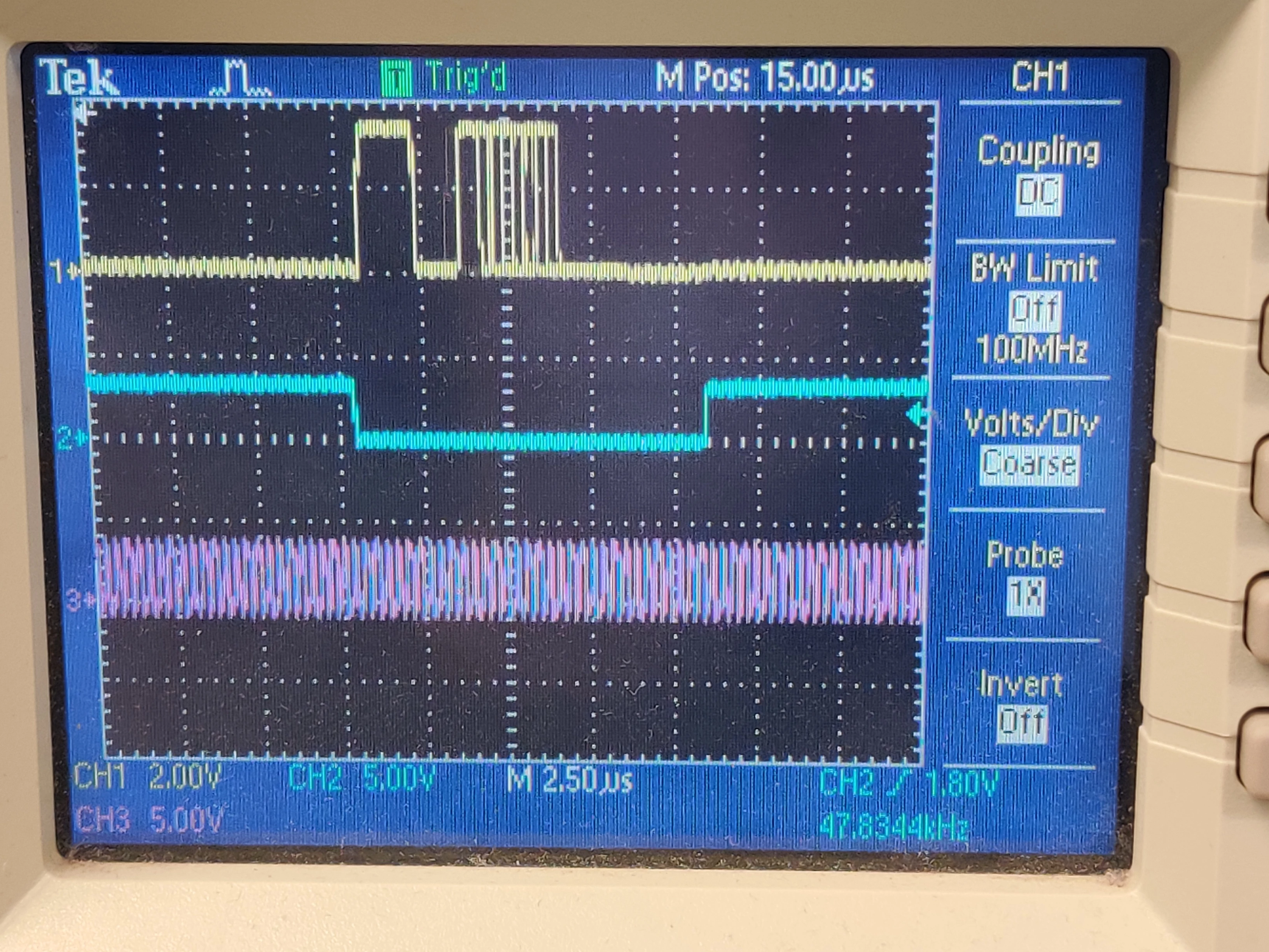

I'm trying to get an SPH0645 microphone to send sound data to my STM32F411 with HAL_I2S_Receive(), but the data I receive is not correct. According to the data sheet, the microphone gives 24 bits data on a 32 bit frame, with 24 bits containing data and the rest being filled with zeroes, which I confirmed by looking on my oscilloscope: (yellow is data, blue is word select and purple is clock)0693W00000aITeFQAW.jpgI try reading this data with the HAL_I2S_Receive() function as shown in the following code snippet:

It takes a little while for the microphone to start, (only zeroes) but after a while you start to see the data from the left channel coming in when the word select voltage is low. (as expected)
But the data is not correct. There's a suspicious amount of values being exactly 16385 between different runs for some reason, and the last 8 bits are not zeroes as the datasheet says. (for example with 16385 being 0100000000000001 in binary)

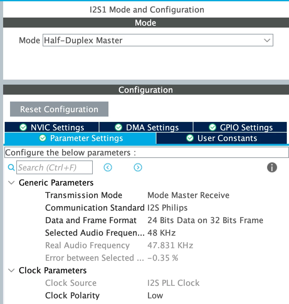

In the CubeIDE GUI I selected the following settings:
0693W00000aIThiQAG.pngI also tried using DMA and received similar data. When plotting the data it doesn't resemble sound data at all either.

Maybe the "Corrupted last bit of data and/or CRC, received in Master mode
with delayed SCK feedback" erratum. Try higher GPIO_OSPEEDR setting for the clock pins.
The rest appears OK to me. Bear in mind that I2S is two's complement and MSB first, so you need to add the two halfs in that way, e.g. sample = ((int32_t)((i2s_data[52] << 16) + i2s_data[53])) / 256 = (int32_t)(63994 << 16 + 16384) / 256 = (int32_t)(0xF9FA4000) / 256 = -101040128/256 = -394688

Thank you so much! The sound data looks great and the LSBs are finally all zeroes!

PS. Even if the data format is 24 data bits in 32 clocks per channel, the DS also says "18bit precision, the LSBs are filled with zeros"... well yeah. So it's just 2 valid bits in the LS-halfword, which is what we see in the data (except the spurious LS bit).
