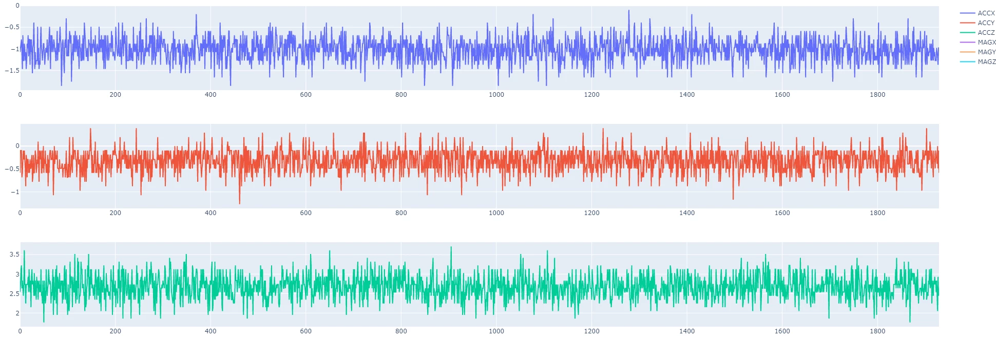

We're having some trouble with our H3LIS331HDL and I'm hoping someone can point us in the right direction.
Below is a recording from a device with the high-G issue on the Z-axis. The device is in a static position on a desk and we're seeing the Z-axis with values of up to 4G. If we change the orientation of the device, the Z-axis still has this high G value.0693W00000HpafKQAR.png

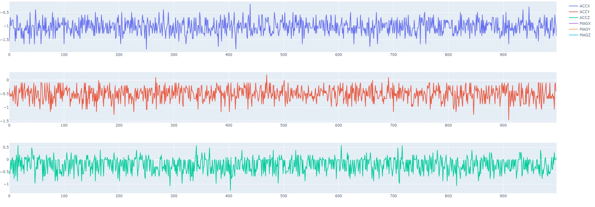

This is what we're expecting to see - a noise range of less than 2G on all axis;
0693W00000HpafPQAR.pngNow for the confusing part - this value shifts over time. We are seeing devices with no G offset issue that passed QA testing have this issue after 3 months of just sitting on a shelf. We're also seeing devices that failed QA at 3G noise now have 6G noise after 3 months.
The high G value isn't just when it is static, the unit when moved in a controlled manner shows the Z-axis reading higher than it should in comparison to a device without the high G issue.

does the issue appear after a mechanical shock (above the devices capabilities), harsh environmental conditions or just randomly?
Since the H3LIS331HDL doesn't unfortunately have the self test feature (that applies to MEMS stator and rotor a known electrostatic voltage), you could try to power OFF and power ON again the chip and check if the issue is still there.
If not, I suggest you to check if the device recovers after a mechanical shock or after a bake condition.
Finally, please note that in the datasheet the Typical zero-g level offset accuracy is defined as +-1g, without upper and lower limits.
