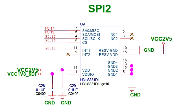

Here we are using H3LIS331DL in our product, using SPI interface. Below is the schematic.
and related code is below.

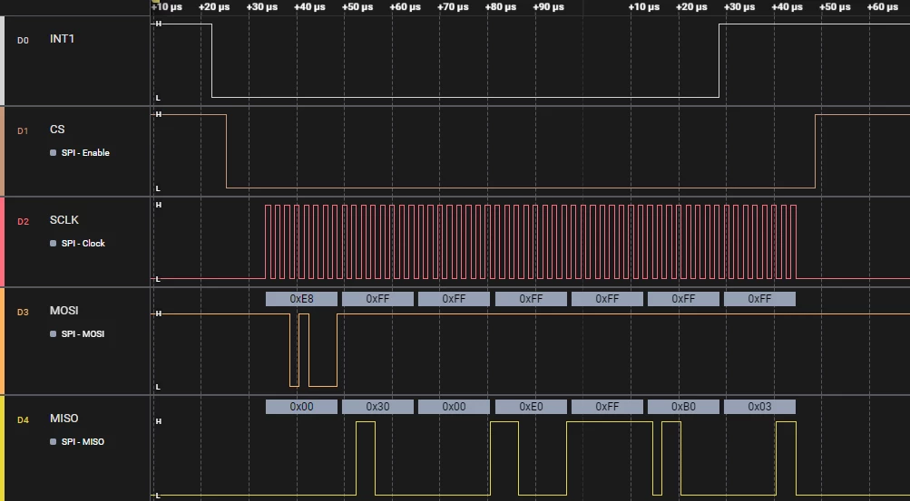

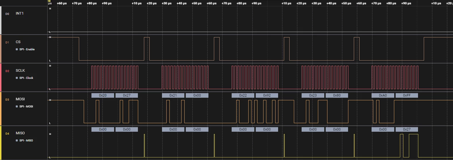

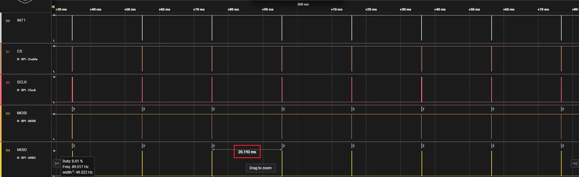

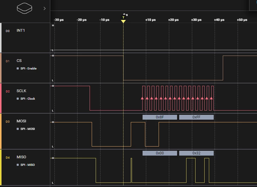

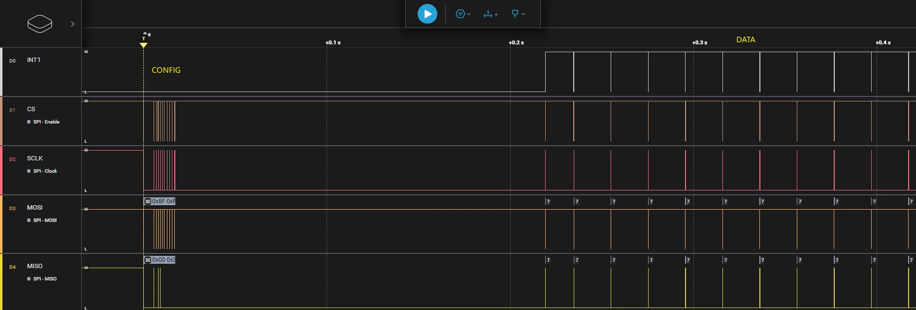

we also captured the waveform as below.
WhoAmI read out.
REG config.
XYZ read out.
And we just put the board steady on the table, but the XYZ vaule is abnormal in this condition.
