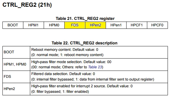

After investigating the INT1_SRC value in more detail I sometimes saw the ZH, XH or YH bit set, but the IA was not.
can anyone please explain what is happening?
I have interrupts enabled for a high events on all axis.
Thank you.

    WHO_AM_I : Read only
    CTRL_REG1 : 0x37
    - normal mode.
    - 400Hz.
    - X, Y and Z axis enabled.
    CTRL_REG2 : 0x14
    - High-pass filter normal mode.
    - data from internal filter sent to output register.
    - High-pass filter enabled for interrupt 1 source.
    CTRL_REG3 : 0x04
    - Interrupt request latched on INT1_SRC register
    CTRL_REG4 : 0x90
    - 200g full scale selection
    - output registers not updated between MSB and LSB reading
    CTRL_REG5 : 0x00
    - Sleep-to-wake function is disabled
    HP_FILTER_RESET : Read only
    REFERENCE : 0x00
    STATUS_REG : Read only
    OUT_X_L
    : Read only
    OUT_X_H
    : Read only
    OUT_Y_L
    : Read only
    OUT_Y_H
    : Read only
    OUT_Z_L
    : Read only
    OUT_Z_H
    : Read only
    INT1_CFG : 0x2A
    - OR combination of interrupts
    - Enable interrupt generation on X, Y and Z high events
    INT1_SRC : Read only
    INT1_THS : 0x02
    INT1_DURATION : 0x00
    INT2_CFG : 0x00
    INT2_SRC : Read only
    INT2_THS : 0x00
    INT2_DURATION : 0x00
    edit 19-3-18:
    fixed CTRL_REG2 configuration typo.

    OK, I see the problem.
    In the configuration CTRL_REG2 : 0x18 you enabled the high pass filter for interrupt  2 source, but then you configured interrupt one (INT1_CFG : 0x2A, INT1_THS : 0x02). So the data without high pass filter are compered with the threshold in the interrupt 1.
    You should set the CTRL_REG2 to 0x14.
