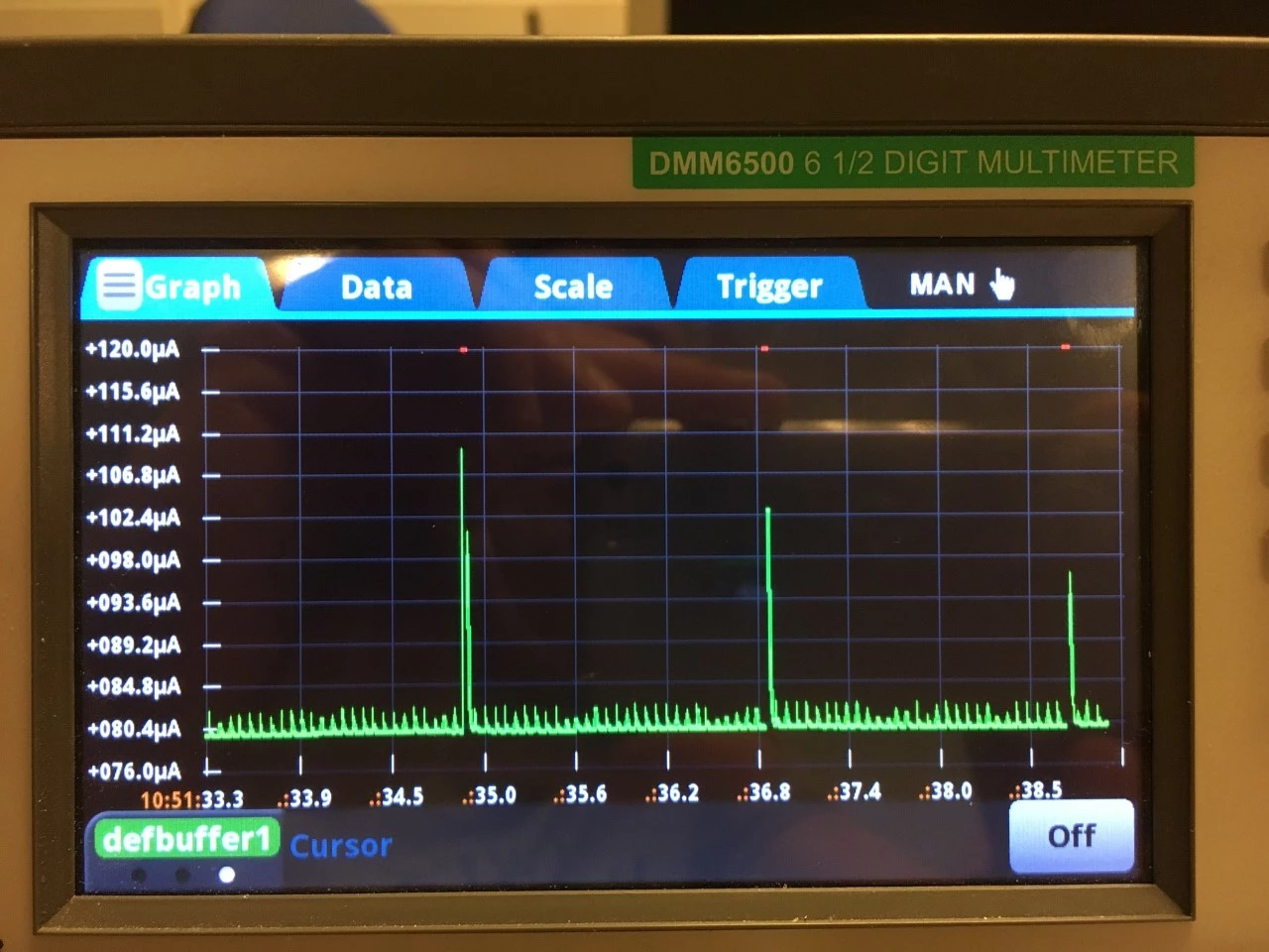

H3LIS331DL: Consumption during 10Hz Low power mode, and wakeup reactivity ?
Is there any ressource describing the consumption during 10Hz Low-power mode ?
On my side I think I can see little peaks each 100ms then one litle larger peak each 2 seconds.
  • Is that the normal behavior ?
  • Is it possible to find a typical consumption curve of the sensor during LowPower mode ?
  • If the 2 second litle larger peak is a particular processing, could it imply a kind of latency before the awaking of the sensor (passing in normal mode, or generating IT), maybe due to the eventual High pass filter ?

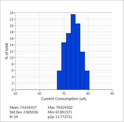

    I believe it is normal to experience higher current consumption during the operativity of the digital interfaces: for example, during SPI/I2C communication the Vdd / VddIO consumption will be higher (especially on VddIO for I2C) since the dataout is communing High-Low and the current consumption is higher during this phase.
    For the Current consumption values in LP mode, you can refer to the datasheet, p. 10. I can say you that that value of 10uA refer to ODR = 1Hz, while the average value at 10Hz is about 75uA.
    In particular, I can share with you some bench data on a representative production samples, but not the I supply vs time graph:
    About the little peak after 2s... do you have enabled some particular event recognition / interrupt triggering every 2 seconds? Otherwise there shouldn't be anomalous peak during (well, there is the possibility to set ODR 0.5Hz, the lowest ODR mode, but it is not your case I see... at least there should not be extra consumption due to the ODR clock tree...).

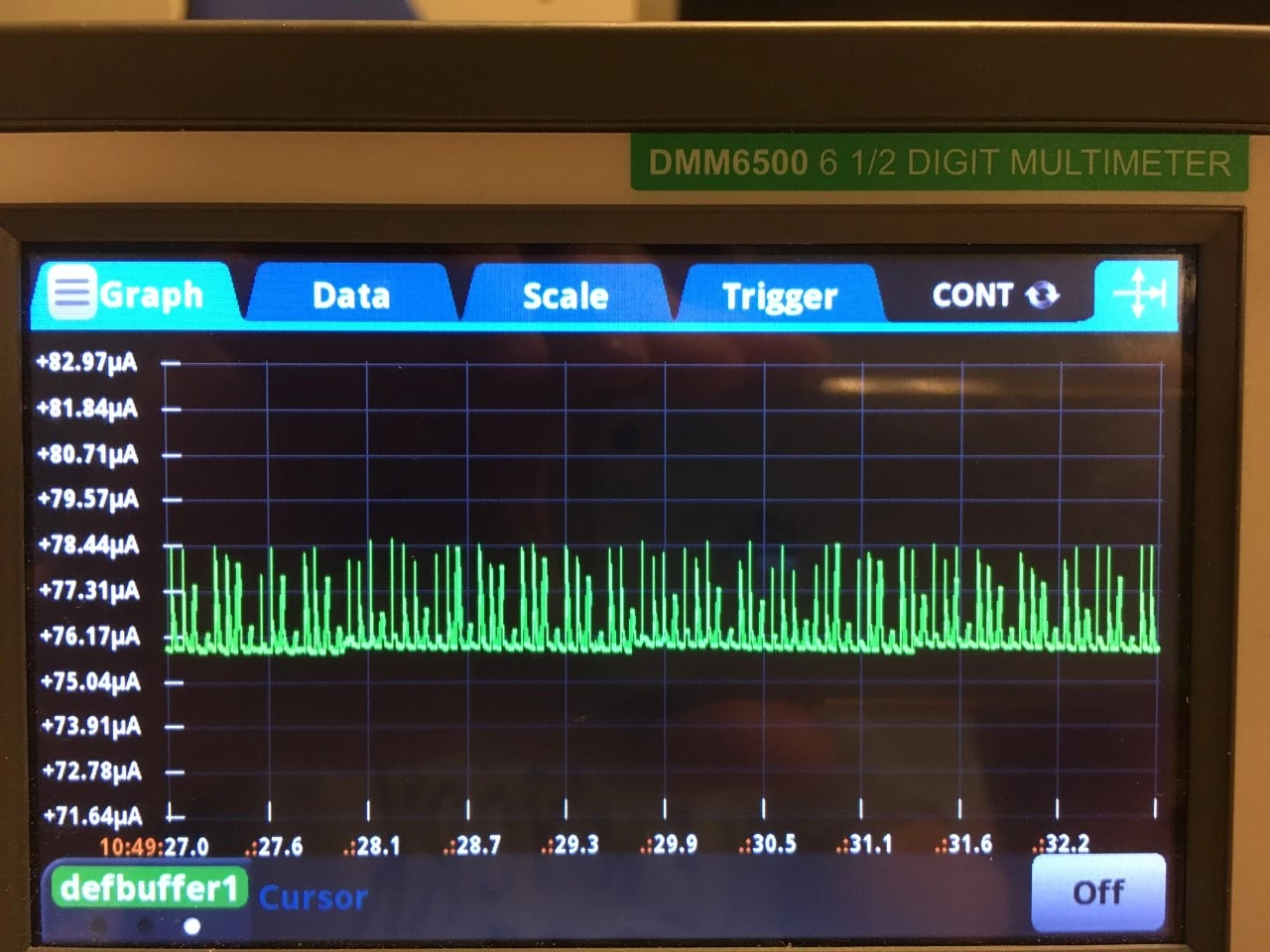

    PGoud
    PGoudAuthor
    Feb 18, 2021 7:30 PM UTC
    Still struggling with my 70 uA to high consumption.
    As an exemple here are my board consumption with H3LIS331DL in "Power down" mode and in "Low power mode 10Hz/100Hz".
    As I told you befaore you can sees the peaks of about 300uA/20ms each 2s. I suppose this could be the working consumtion in LowPower mode. Could you confirme me that .
    But My problem remain with the 70 uA FEET of consumtion, notice I could also measure abou70 uA directly on the VCC of H3LIS331DL in any of these modes ...
    I tried using INT1 in "open drain" with pull up on MCU side, and in PushPull without any pull on MCU side. In both cases I use "Active low" modes.
    Please any idea is welcome

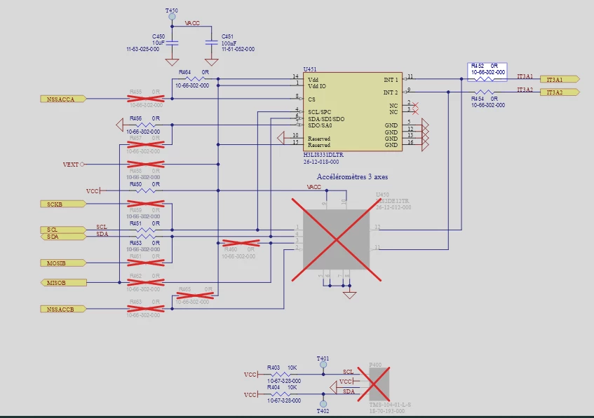

    PGoud
    PGoudAuthor
    Feb 19, 2021 1:30 PM UTC
    I'll make more tests this afternoon.
    However here is our schematic of Accelero's part.
    Eleon BORLINI
    Feb 19, 2021 2:10 PM UTC
    Schematic looks ok... Which is the Vdd/VddIO value?
    -Eleon
