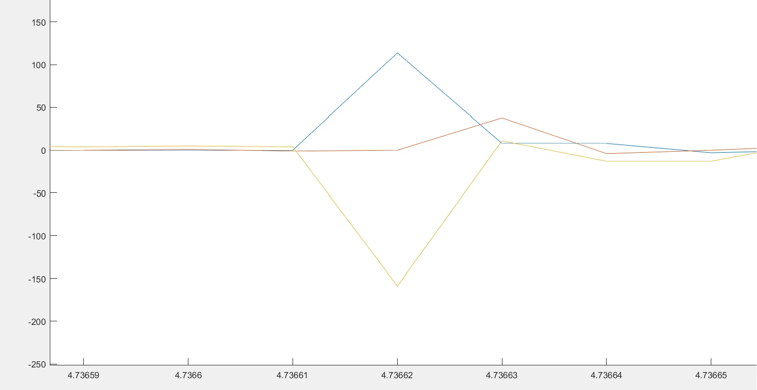

If i shake the sensor board, acceleration is produced in the corresponding axis. but if i tap on the board, to produce higher g values, say 200g - 400g, the acceleration spike is seen in all the 3 axis, not just axis which I had tapped.

Posted on February 28, 2018 at 09:26
Please provide your sensor configuration and a plot of X, Y, Z data during the tap.

Posted on April 17, 2018 at 11:08
Configuration data sent via I2C in the following order:
                                                            Register address   Value written
Set data rate and enable all 3 axis :            0x20                   0x3F
Scale selection : +/- 400g :                          0x23                   0x30
Filter settings for offsetting the errors :        0x21                   0x1F
Reference for high pass filter = 0g :            0x26                   0x00
Interrupt threshold :                                     0x32                   0x70
Interrupt setting :                                         0x30                   0x2A
Plot of all the 3 axes during tap:
Data rate 1 kHz.

Posted on April 19, 2018 at 10:08
The configuration seems to be correct and the behavior is normal. The tap is never be exactly along one axis so the sensor will move little bit in all directions.
