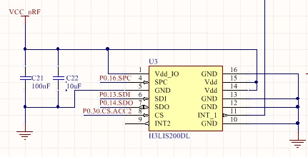

we are facing a problem to shut down h3lis200dl in our design. VDD is connected to VDD_IO and power is always connected to 3V battery (even when device is turned off). We are using SPI-communication and reading/setting registers works fine. It is just that I can't achieve anything near 1uAmp power down mode current consumption as stated by the datasheet even if setting PM0-PM2 to 0 (i.e. register 0x20 to 0x07) to power down the unit. The unit keeps consuming around 50uAmps.
Any ideas what might be missing here?
thanks
Olov

    What is the voltage level on SDO pin when you measure the current consumption?
    Can you share your schematic?

    Hi Miroslav, thanks for your response. in power-down mode I measure SDO=3V, SPC=0V, CS=3V, SDI=0V. Hope this helps!
    Some additional notes: Schematic connection of H3lis200dl is found in the first post. After measuring again the circuit actually consume about ~90uamps in power-down mode. Patched the board and released VDD_io (pin 1) on
    H3lis200dl to floating. Current consumption then decreased to ~50uamps..
    We also have flash memory and ST IIS2DH accelerometer connected on same SPI-bus. Both of those circuits implement pull-up only on SDO and we have no problems with these two circuits only on the bus. Noted in H3LIS200DL datasheet that it has pull-ups on all of SDO, SPC, CS and SDI. Would you know what value these pull-ups use, maybe this could be the explanation?

    The current consumption is caused by internal pull-up.
    When no communication is ongoing, data on CS, SPC, SDI and SDO are driven by internal pull-up resistors.
    The solution could be to ensure the high state (3V) at the data pins when there is no communication.
