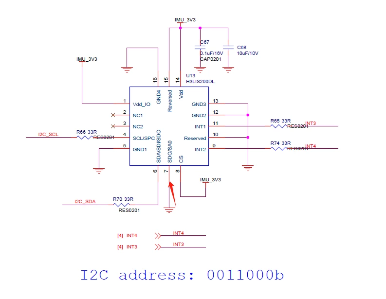

H3LIS200DL -how to Disable the pin7(SDO/SA0) internal pull up
As shematic below the pin7 is connected to GND so there will be a 60uA leakage .so how to disable the internal pull up by config the register.

Hi @EthanYao ,
Unfortunately is not possible to disable the internal pull up on the pin 7.
