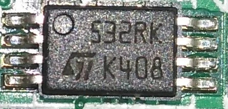

Good day! how i can recognize the chip labeled like on photo.. Thank you

The marking 532RK stands for the M95320-RDW6, i.e. an 4Kx8 EEPROM.
