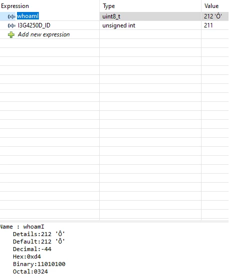

When using this function to read the "WHO_AM_I" register (Address: 0x0FU) I am supposed to get the hex value "0xD3U" (Decimal: 211) but the function call sets the wrong value in "bufp". I get hex "0xd4", following is a screenshot from a debugging session:
 0693W000005AknEQAS.png"whoamI" is the value that gets sets from reading the register and "I3G240D_ID" is the expected value.
In binary the expected value is: 11010011, this is correct according to manual of the gyroscope, but what I get is: 11010100.

Eleon BORLINI
Eleon BORLINIBest answer
Nov 11, 2020 2:02 PM UTC
Hi @Fatih​ ,
well, I believe I found the issue...
The fact is that on the STM32F429 the mounted device is the L3GD20 instead of I3G4250D, for which the WHO_AM_I is 0xD4.
You can see it by considering the software package related to this hardware platform, the STSW-STM32138. In the folder Utilities\STM32F429I-Discovery, you can see that in the stm32f429i_discovery_l3gd20.h is declared the following:
#define I_AM_L3GD20		 ((uint8_t)0xD4)
So I suggest you to use this code as starting point, instead of the C libraries on Github.
If it solved the issue, please mark this answer as Best answer so that t can be useful for future users.
