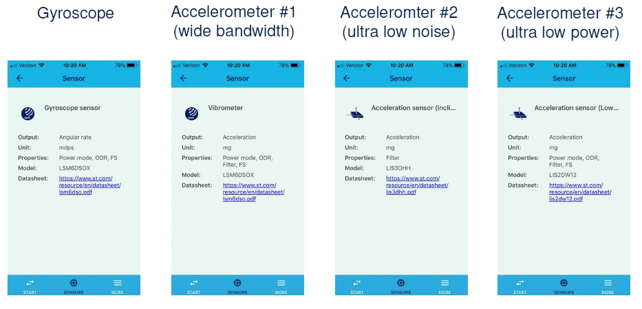

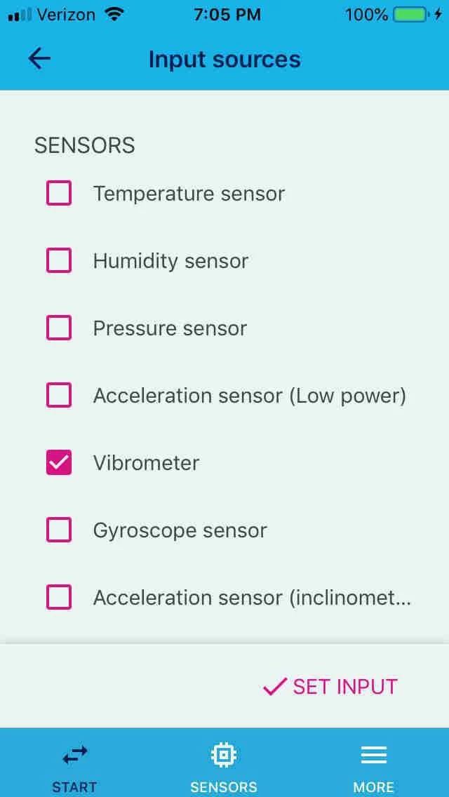

    Hi, you have to select the correct accelerometer from the list below. In particular, see the picture below that I took from this presentation:
    https://www.st.com/content/dam/AME/2019/technology-tour-2019/minneapolis/presentations/T3S1_Minneapolis_SensorTileBox_HandsOn_A.Vitali.pdf
    Then you have to stream data to the SD card as output.

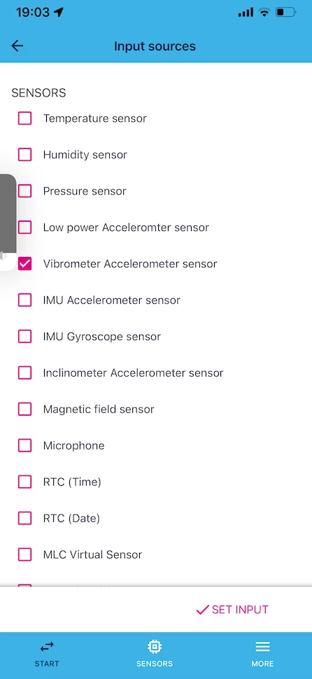

    actually It seems l already configure same way.(iOS is a bit different view )
    0693W00000GXFHqQAP.pngdo you know which way is X axis?

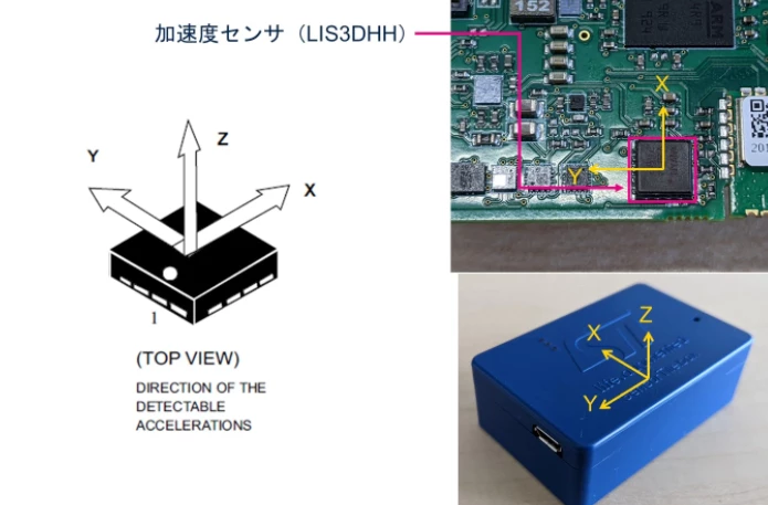

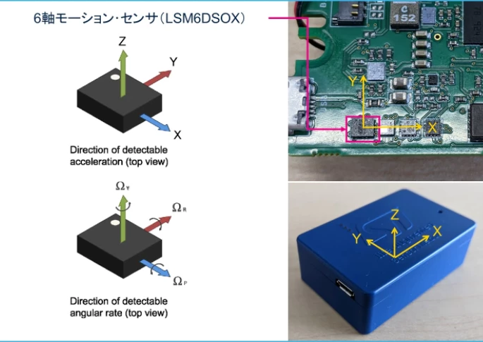

    The reason why I thought LIS3DHH might be used is based on the following data.
    0693W00000GXFJcQAP.png0693W00000GXFJmQAP.pngThe X-axis and Y-axis are different for each sensors.
    In this setting, it's LIS3DHH axis. (or maybe this document is incorrect,,)

    Hi @Yinui.1​ ,
    the axes of the accelerometers should be remapped in the firmware to be coherent for every sensor, so that when you plot the data the axis show the same behaviour, even if they are not positioned the same way
    I can confirm that when you choose the accelerometer, you should follow the advice given by @JWu.12​ , to select the one you want to look at =)
