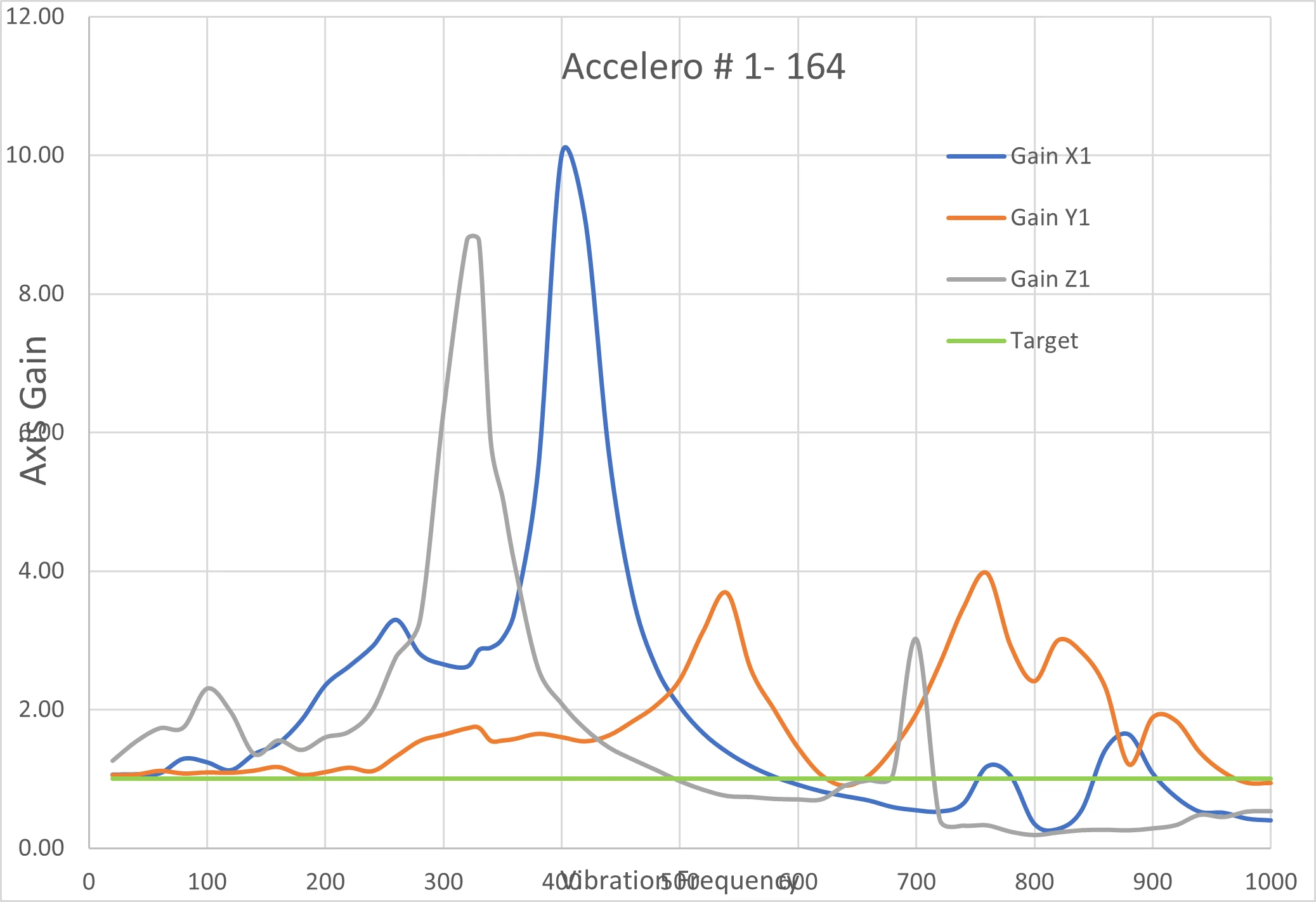

Gain problem with ST accelerometer
we are trying to test ISM330 for recoding acceleration signal in a BW of 10-1000Hz. We have done the test on a few different sensors with a calibrated shaker. The results show quite erratic and non-linear behavior even from the low frequency of 100Hz.We are really puzzled of this behavior. Below are some sensor Gain plots. reference line is a Gain of 1.based on the constant amplitude input from the shaker.
Below is the register dump from the sensor. We only have the LP filter on and no other filters and are removing the average from the raw data to take out the DC offset.

Your feedback is much appreciated.

    Eleon BORLINI
    June 8, 2022
    Hi @BSago.1​ ,
    which amplitude (in "g") are you using for your test?
    -Eleon
