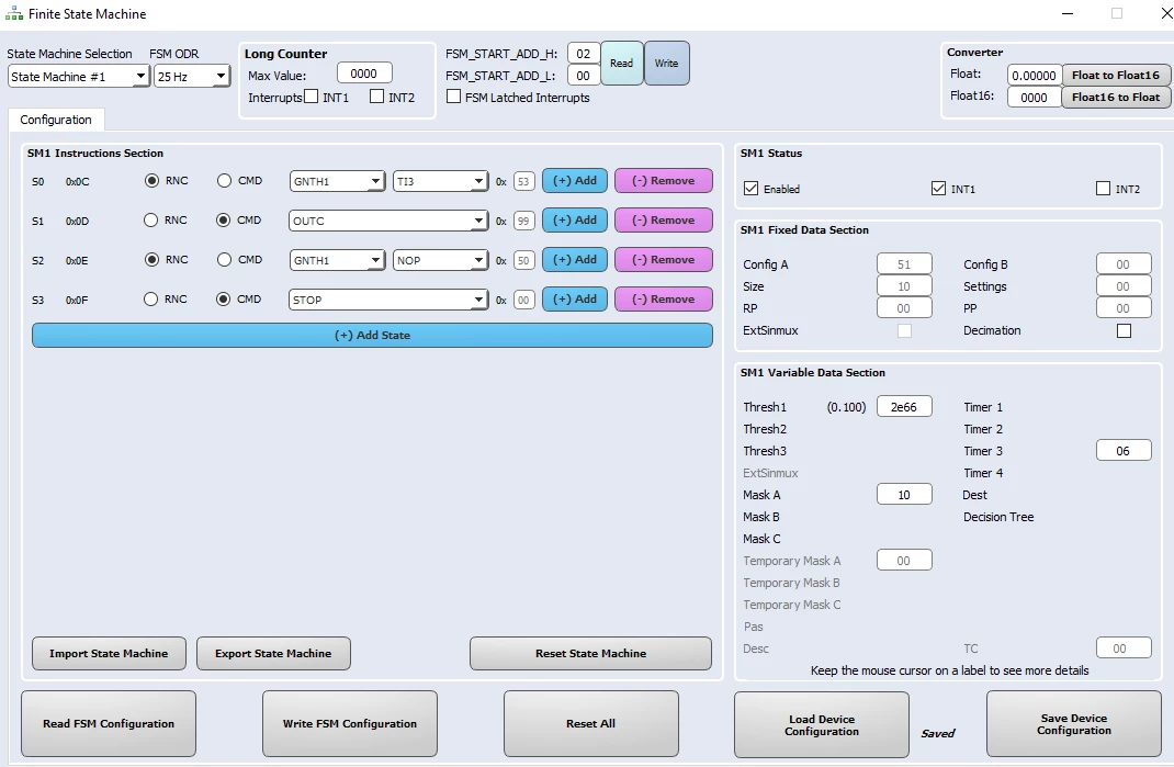

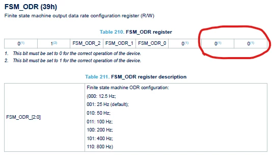

I am suspecting that the ODR setting in my application is not correct. I want to be using 25Hz so according to the datasheet I would set register address 39h to 48h. 25Hz equals 001 which would give 01001000 = 48h.
But all examples and also the Unico tool outputs 4Bh instead of 48h. Am I missing something or should the last two LSB bits always be 1 instead of 0?

I didn't realize you were using the FSM tool, we checked and you are right: this is a bug. I have already warned to fix it in the next version. In the meantime you can manually change the value of register 39h from 4B to 48.

Thank you for the answer. I don't have access to the evaluation kit so I can not read out the values like that. However, I tried the below configuration from the Unico-Gui (using the LIS2DUXS12) and the resulting code when saving the Device Configuration results in 4Bh stored in position 39h.
The resulting .ucf file:

Ac 39 4B
