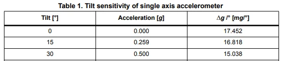

>> Can you give more light on weight setting , offset setting for each axis. Is that offset unit is 'mg' or it is angle, the maximum value of THS is 6 bits, so how it will be related to a large angle value.
the AN4509 reports some of the thresholds related to the tilt degrees. Suppose you have your device with the z axis measuring 1g (flat position), the x and y axis will measure 0 LSB = 0 mg. If you set the threshold at 15° and enable X_WU and Y_WU (not the Z_WU), because the Z_WU would always generate an input when in flat position (Z = 1 g).
0693W000004Jcc7QAC.pngFor the threshold calculation, please consider what reported in the datasheet p.48: Wakeup threshold, 6-bit unsigned 1 LSB = 1/64 of FS. Default value: 000000.
