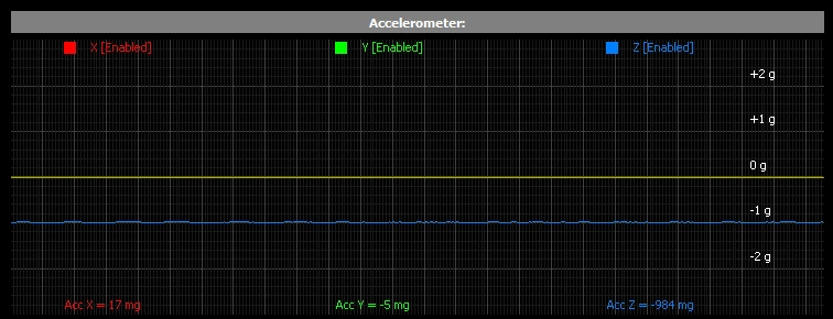

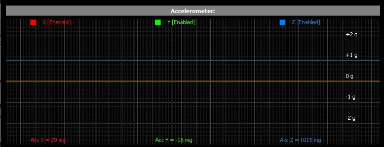

Eleon BORLINI
October 28, 2020
You can simply turn upside down the accelerometer: in one case, you will see the earth (gravity) acceleration with positive sign in one position, and negative in the other position...
