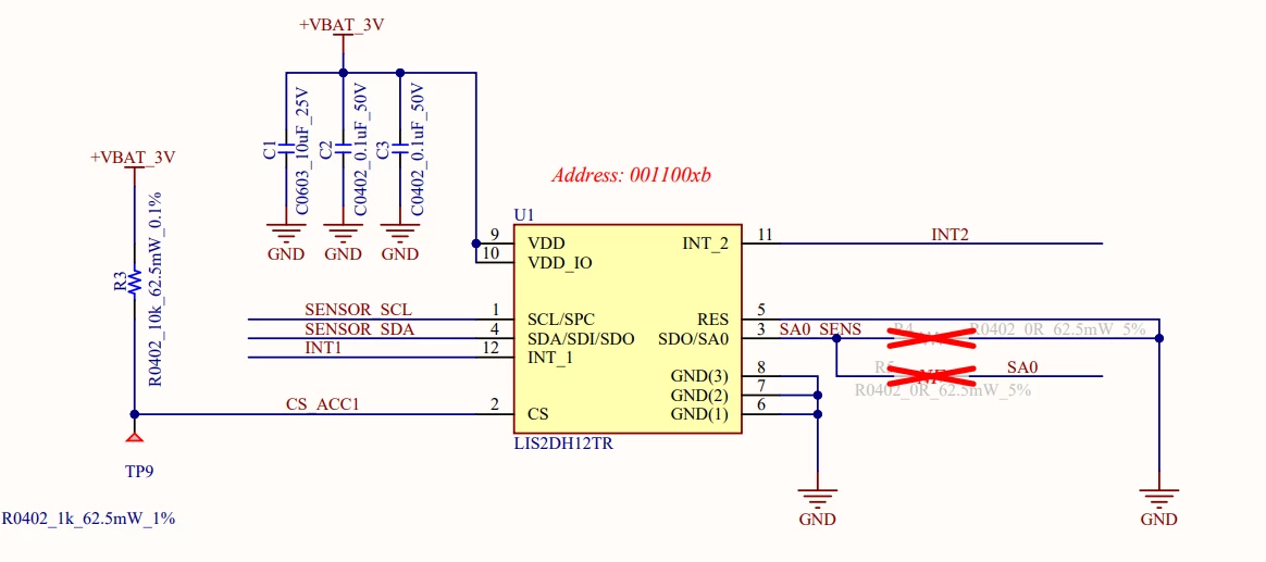

I am not getting the free-fall interrupt using lis12dh12.
configured all the register settings as per the below document, but not getting any Interrupt but I able to see the x,y,z raw values.
en.DM00500824.pdf (st.com)
please help me. not raised any fall interrupt?

Hi Eleon,
Thanks for your response, I did the same steps and still not caught any free fall interrupt. plz find my hw portion. Is there any issue with my design to get the interrupt.
But I am getting the xyz axis data and not free fall alert.
0693W00000GXjlbQAD.pngRegards,
Ani

Hi Ani @Akuma.6​ ,
the schematics looks correct, the SDA and SCL lines should be connected to the Vdd IO via pull-up resistors, but you might have done in another section of the schematic. Just one question: is the SA0 pint floating?
Did you check from the raw data if you are actually crossing the free fall threshold limit? Can you share the raw data here?
You might also try to configure the interrupt, latching it (i.e. acting on the LIR_INT1 bit of the CTRL_REG5 (24h) register), or reducing the interrupt duration from 03h to 01h or 00h.
-Eleon
