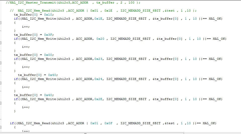

Hello People,
I am trying to get data over i2c from LIS2DE12  sensor. Here I am attaching a screenshot so you can see the way I am configuring its register to read data for x,y and z axis. I dont want to use any interrupt. Simply want to read data.

I want to get data from
LIS2DE12 sensor
continuously. I have made configuration to fetch data for x,y and z. But I am not sure wheather they are perfectly configured or not because I am getting same data every time I run the program even if I move the sensor the data remains same. Can you help me with this with proper step by step procedure.

Please share the sensor configuration in some easily readable format (register + value).
NItin Kanani
March 12, 2018
Posted on March 12, 2018 at 10:57
Hi Moroslav
Thanks for your suggestion. its work.

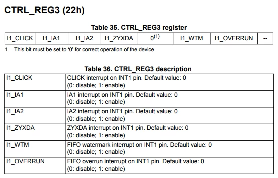

If i use data ready interrupt in INT1 pin. then which configuration i do?
Thanks
Nitin Kanani
March 12, 2018
Posted on March 12, 2018 at 15:14
To enable DRDY interrupt on INT1 pin set the bit I1_ZYXDA in the CTRL_REG3.
