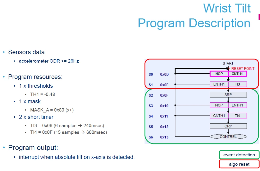

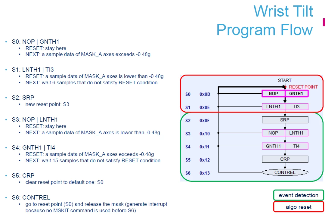

Hi @sde c.1​ ,
I would suggest you first to check the DT0077 Design tip, that describes some examples for the configuration of the FSM in the LIS3DSH.
A way to deal with the tilt example could be the following one:
By the way, there are a lot of more example for the FSM of LSM6DSO(X) sensors' family, that is similar in the core to the one, but has much more literature: for this, I suggest you the AN5226 application note and the C Github examples.

Apr 13, 2021 2:32 PM UTC
does not work, and examples doesn't help eather.
Any idea why my inititial code does not work ?
This code i created according the above example. Datarate = 100
