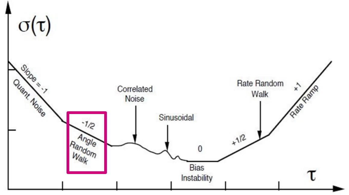

I am having uncertainties when calculating displacement and change of angle effected by random walk.
I want to know proportion of failure in measurement caused by random walk.
In the datasheet of ISM330DLC random walk (ug/sqrt(h) is declared as noise density (ug/sqrt(Hz)).
I found different approaches in calculating effect of random walk effecting displacement and got confused.
Example:
noise density: 75 ug/sqrt(Hz) -> converted to ARW: 1.25 ug/sqrt(h)
displaceent after 1 min
Approach one (which I can imagine is correct):
s = 0.5*9.82(ARW * sqrt(t(h)))*t^2
= 0.5*9.81(1,25 ug/sqrt(h)*sqrt(1/60))*60^2 = 2.85 mm
Approach two I found:
s = 9.81* noise density *sqrt(t) *t
s = 9.81*(75 ug/sqrt(Hz) * sqrt(60))*60 = 0.341 m
Can anyone help and/or does have some sources with useful information?
Thanks a lot!!!
    1 reply
    Eleon BORLINI
    July 17, 2020
    Hi @APfel.1​ , regarding your sentence
    Well, the ARW is only a component of the total device noise monitored in time, and it is not declared in datasheet. I can share you some characterization values for the ARW: avg on roll axis [4.37mdps/sqrt(Hz)], avg on pitch axis [4.28mdps/sqrt(Hz)], avg on yaw axis [4.55mdps/sqrt(Hz)].
    You may however refer to the velocity random walk, the VRM, calculated on the accelerometer, whose values are: avg on x axis [49.7ug/sqrt(Hz)], avg on y axis [46.4ug/sqrt(Hz)], avg on z axis [53.9ug/sqrt(Hz)]
    Regarding which of the two approaches should be used for the calculation of the displacement from the noise, I believe the one showing the conversion formula from acceleration to space is the correct one:
    • s = 1/2*a*t^2.
    Regards
