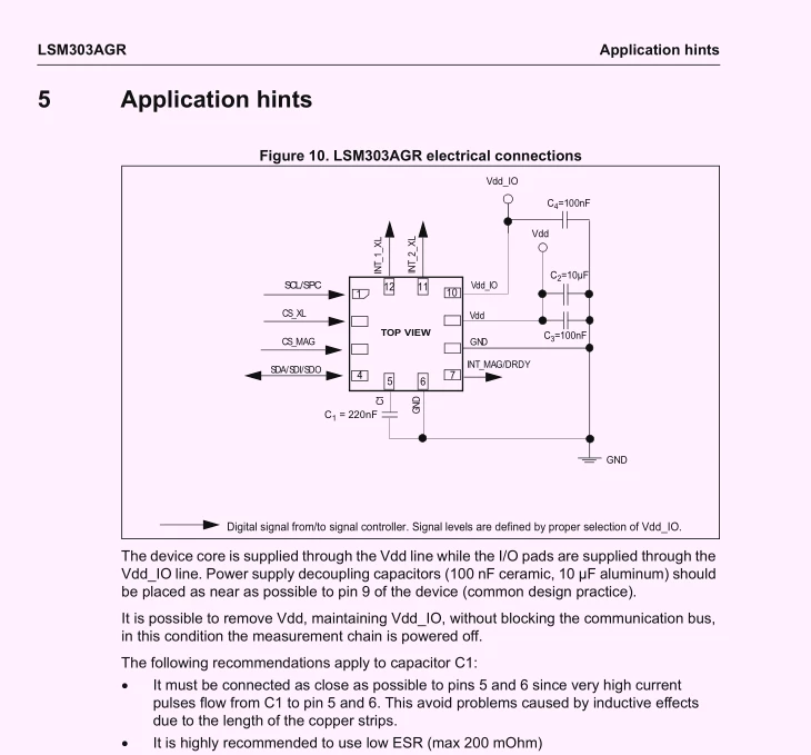

Electrical Connection circuit of LSM303AGR How important are using C2 10 uF aluminum and C1 low ESR (datasheet, figure 10). Can I use C2 10 uF ceramic and C1 ceramic any ESR?

    December 12, 2018
    For prototypes used in room temperature, it should be OK.
    For final products use recommended capacitor with low ESR.
