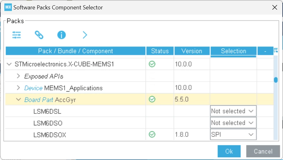

Added in Software Packs Component Selector an LSM6DSOX - SPI (v1.8.0):

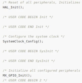

When testing lines added to main.c I get an error from compiler in:
lsm6dsoxDriver.handle = &hspi1;
../Core/Src/main.c:110:32: error: 'hspi1' undeclared (first use in this function)
110 | lsm6dsoxDriver.handle = &hspi1;
There are more errors, but this one is first that I'm not able to fix

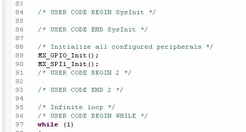

in your code i see no hspi init:
so : define spi in Cube -> generate code ! and compile again...hspi should be there then.

November 14, 2023
hmm...
did the steps again with a special care of:
- Cube -> Project -> Generate Code. (this switches view to main.c)
- Cube -> Project -> Build All.
Nothing new appears in section you showed.

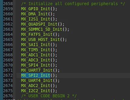

btw no need for "build all" ; just use the nice symbols : the gearwheel to gen.code, the hammer to compile. :)
see - all used units get a call for init:

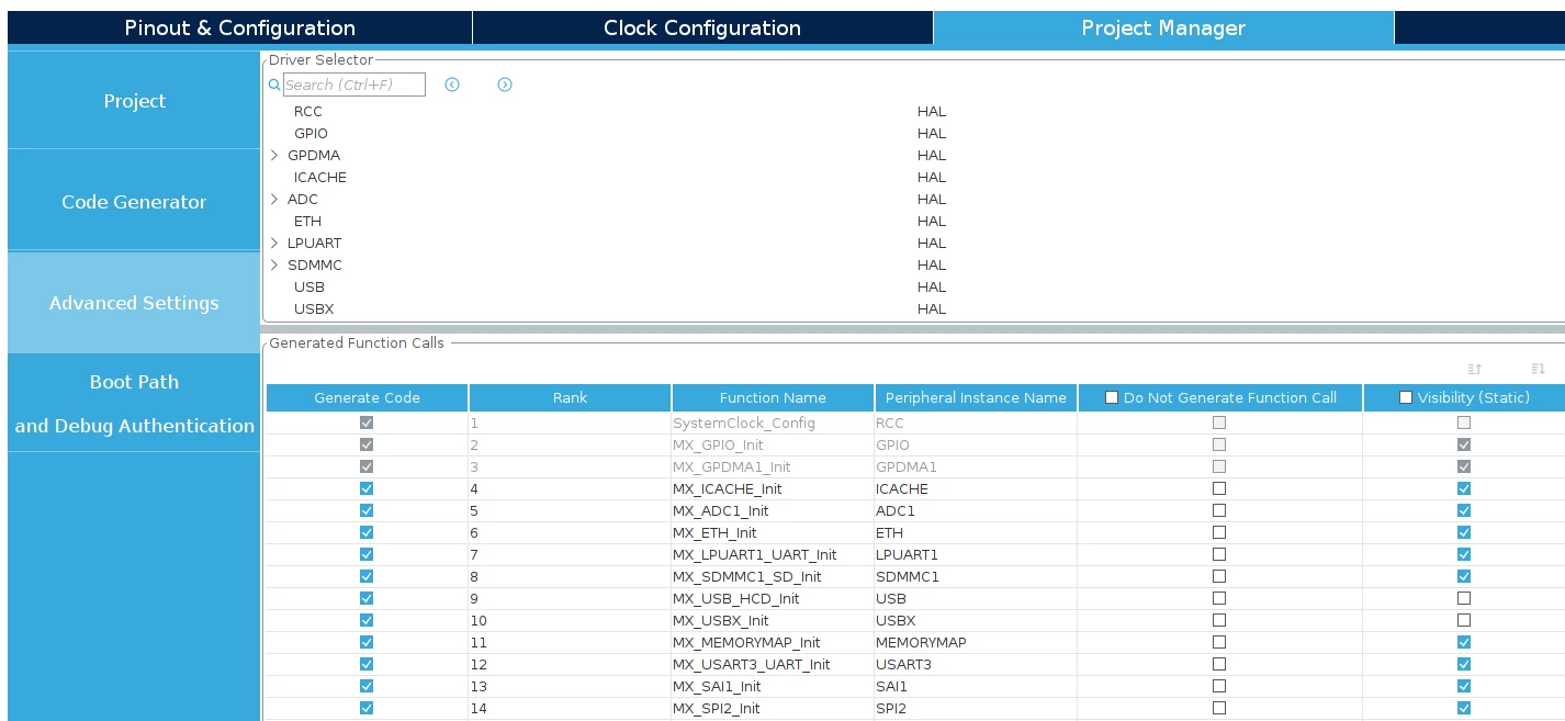

except you dont want it -- see in project manger -> advanced settings:
when you activate/use the spi - is the mx..init active and also no "do not ge. function call" set ?

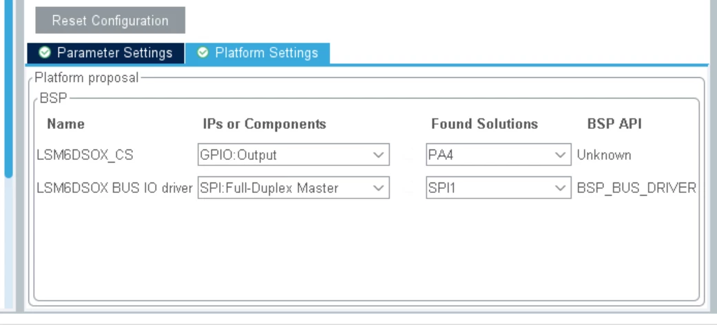

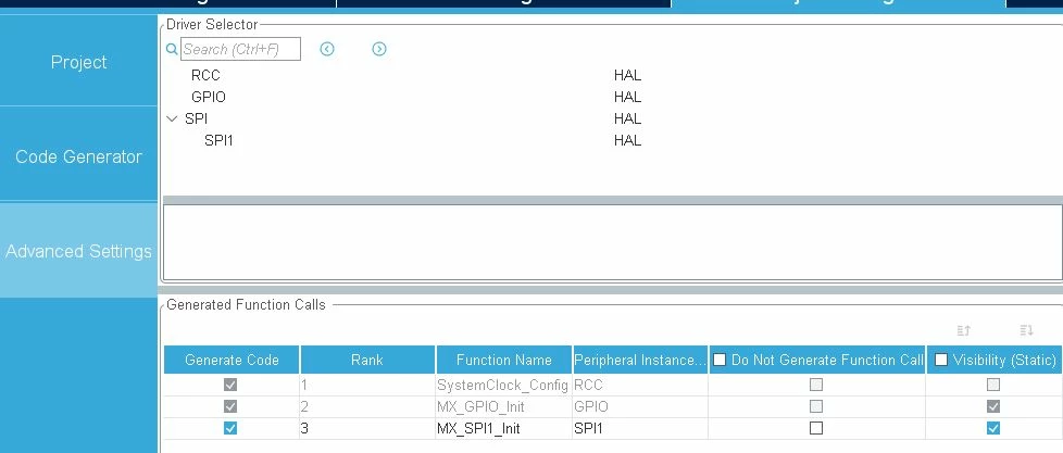

If I leave undefined BSP_BUS_DRIVER
then SPI is visible in Advanced Settings:

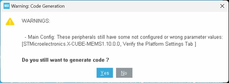

When gearwheel is pressed a Warning appears.
If Yes is pressed, code is generated:
I think I'll live with it :)
