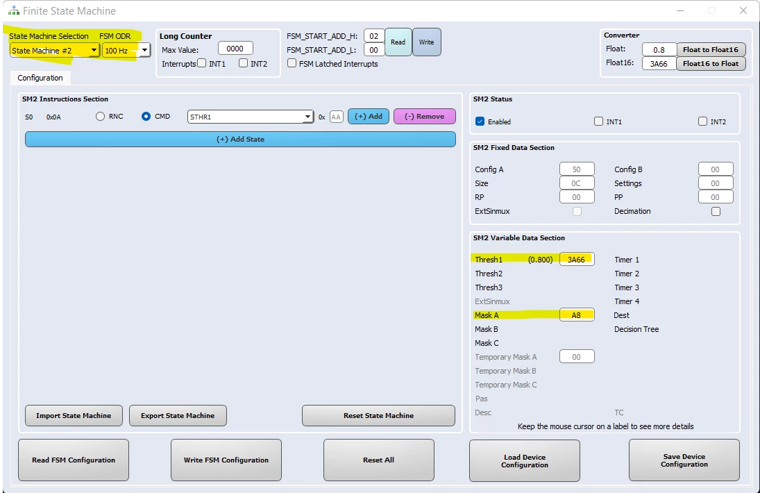

    when do you suggest to use the command STIMER3  (or the others commands), are you suggesting to use the Unico Gui Tool?
    For example, if I want to change the value for threshold 1 of the FSM2, should I do a configuration like shows the picture in attachment?
    In this case, following the procedure which generates C code, I should reconfigure the entire accelerometer (in fact the file .h for example contains the reference of the register CTRL5 ), am I right?
    If my guess is correct, how could I implement the commad SETP?
    Now, in our application, to change the parameter of the FSM I directly change the register after stopped the FSM machine . I've determinate the address from the file .h generate from the Giu Tools. Following this steps, what's the problem?
