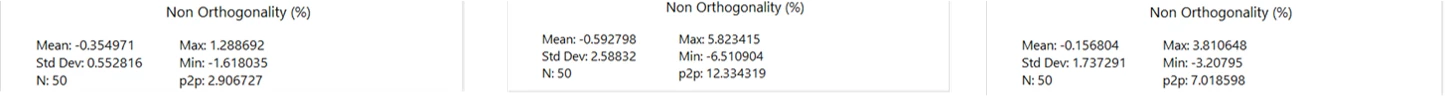

Do you know the following characteristics (typical values) on the gyroscope and accelerometer of LMS6DSM : - Scale factor - Axis misalignment - Bias stability ?

Hi @NPoth.1​ ,
yes, I can share you some characterization / bench measure data -especially on the last two parameters-, since they are not in the datasheet:
  • Scale factor: the LSM6DSM is digital, so the exact conversion factor from voltage to digits depends on the internal ADC. However, the sensitivity -that depends on the selected Full Scale-, is defined in the datasheet, p.23: for the accelerometer, (milli)g stands for 9,81m/s^2 (/1000), the Earth gravity acceleration, while dps stands for degree per second. For example, in the FS=2g case the accelerometer sensitivity is 0.061 mg/LSB, meaning that a variation of 1 bit in the data output refers to an increase of 0.061 milli-g sensed.

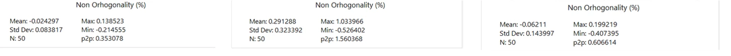

  • Axis misalignment (i.e. "cross axis" parameter, or non orthogonality):
    • For the accelerometer (X to Y, X to Z, Y to Z):
  • For the gyroscope (Pitch to Roll, Pitch to Yaw, Roll to Yaw):

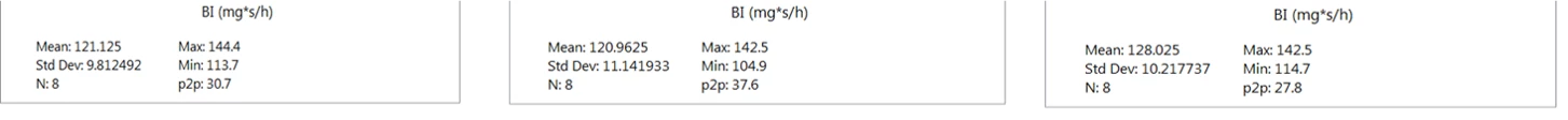

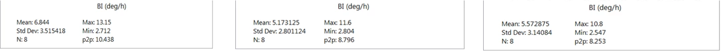

  • Bias stability:
    • For the accelerometer:
  • For the gyroscope:
  • Bias stability:

NPoth.1
NPoth.1Author
Mar 23, 2021 2:17 PM UTC
You answered my questions concerning axis misalignment, thanks a lot !
Regarding the bias stability, can you tell me the observation time (period) ?

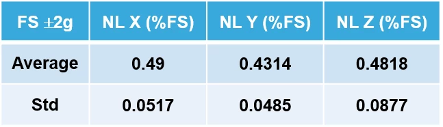

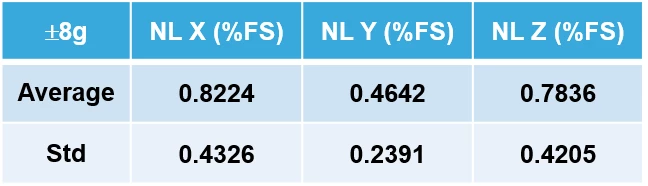

Regarding the scale factor, I'm interested in the accuracy of the scale factor (not of the scale factor value itself). Do you have typical values of the accuracy (precision) of the scale factor for gyroscope and accelerometer (in ppm or %) for FS=+-8g and for FS=+-2g?

For the bias stability, the observation period is 72h.
For the accuracy/precision parameter, I can share you the sensitivity error in non linearity:
0693W000008xhrwQAA.png0693W000008xhZoQAI.png-Eleon

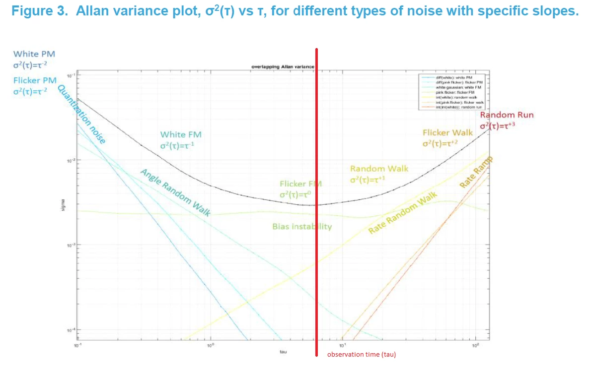

For the bias stability, I expected an "observation time" in second. For me, the "observation time", is the value on the x-axis (tau) where the Allan variance is smaller.
For the accuracy/precision parameter of accelerometer, thanks, you answer my question.
