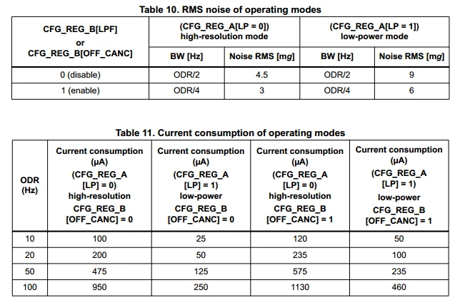

Do all current consumption of lis2mdl tested in 2.5V?
  • December 16, 2019
  • 1 reply
  • 750 views
In the spec, Table 10 and Table 11 show's the current consumption when LIS2MDL working in different modes. But it doesn't verify the test voltage. Please help to confirm if they were measured in 2.5V. Thank you!
1 reply
Eleon BORLINI
December 16, 2019
Hi @Czhan.15​ , I confirm you that all these current consumption are valid for Vdd=2.5V, which is the typical Vdd for LIS2MDL (and below voltages). Regards
