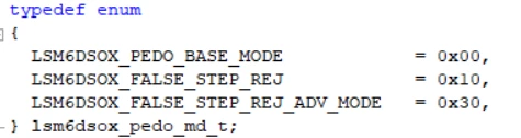

I am implementing the pedometer function using LSM6DSOX.
According to the driver file provided by ST, there are three different modes to configure. I want to know the difference between them. I cannot find any information in the datasheet.
Appreciate your help!
Maybe it's related to table 406. PEDO_CMD_REG register description - From DS12814.
From AN5272:
  • False-Positive Rejection block, which can be enabled by setting the FP_REJECTION_EN bit of the PEDO_CMD_REG embedded advanced features registers to 1. This block performs real-time recognition of
    walking activity based on statistical data and inhibits the step counter if no walking activity is detected.
  • Advanced Detection block, which can be enabled by setting the AD_DET_EN bit of the PEDO_CMD_REG
    embedded advanced features registers to 1. This block recognizes a low-energy gait (e.g. device held in the
    hand and very slow step cadence) and automatically switches the internal configurations in order to better
    adapt the pedometer algorithm to this condition. This block works together with the False-Positive Rejection
    block, then also the FP_REJECTION_EN bit must be set to 1 as well.

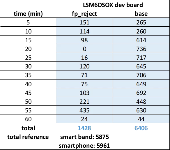

I found that if I set the pedometer to false_positive_rejection mode, after I run/jogged, the number of steps counted was very small. So want to know more detail information how the differences are.
Since the statistical data are used for the algorithm, do you know if the running is also counted as steps in false_positive_rejection mode?

Thanks a lot for your kind reply. I have performed an experiment today and got the below results. The dev boards were grasped in my hand, and the smartphone was placed in my pocket. The data are just for your reference.
I was running for 1 hour the experiment (and there are some walks for temporary rest), seems the default configuration of fp_reject algorithm does not accept fierce activity such as running.

Hi @Jiabin ,
probably the position of the sensor is also involved in the low accuracy, maybe you can try again the test with the board in the pocket to be sure =)
anyway, remember that you can also tune the algorithm or even try to develop a Machine Learning Core network that is tuned to your running/walking logs to further increase accuracy =)
