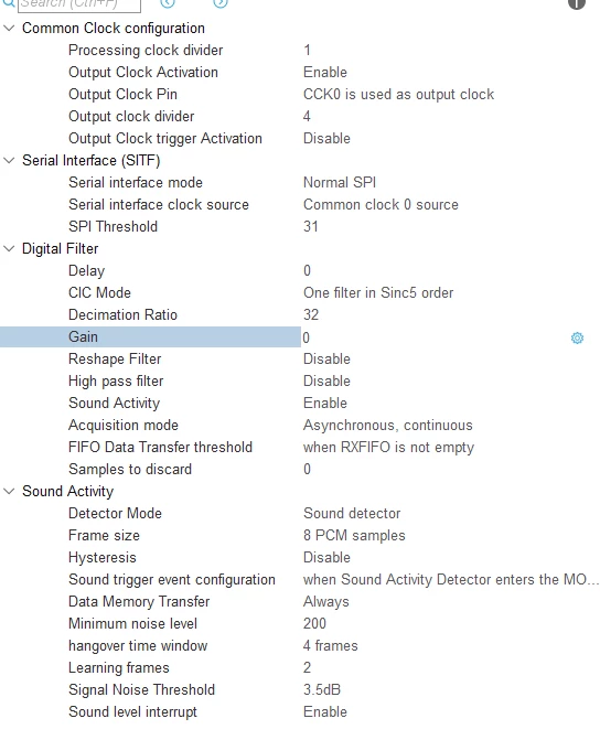

My configuration is as follows:
I have as ADF input clock: MSIK@12MHz
Then a Output clock divider set to 4. So my output clock would be 3MHz.
_legacyfs_online_stmicro_images_0693W00000bhgsJQAQ.pngpins are:
PE9: ADF_CCK0
PE10: ADF_SDI0

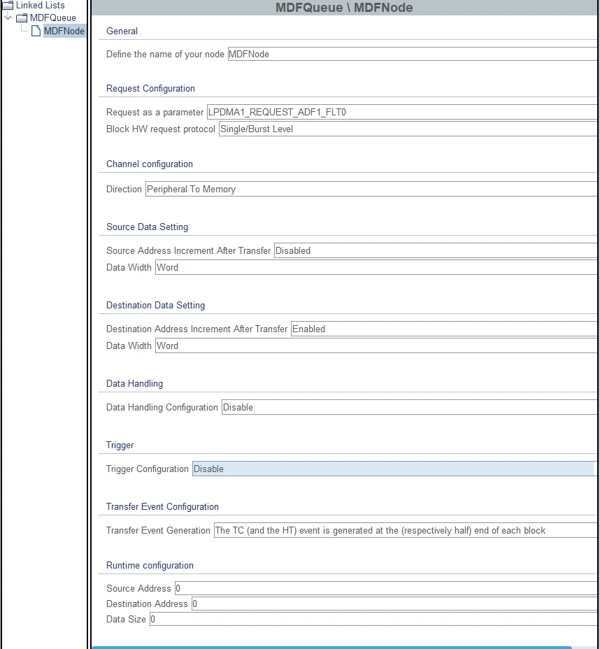

This is the LPDMA section(copied from the ADF_AudioSoundDetection example):
_legacyfs_online_stmicro_images_0693W00000bhgtvQAA.pngAnd this is my callback function
void HAL_MDF_SadCallback(MDF_HandleTypeDef *hmdf)
 HAL_GPIO_TogglePin(LED_GREEN_GPIO_Port, LED_GREEN_Pin);
Unfortunately nothing happens.
