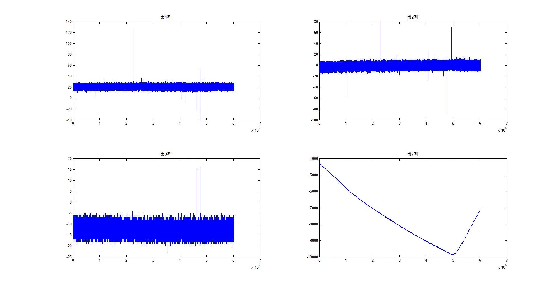

Hi! I am using ISM330DLC to get data from all three gyros and three accelerometers with an ODR of higher than 400Hz. When the circumstance temperature is going down from normal to about -20~-30℃, there are several disturbance in outputs of gyros (different from noise). This phenomenon only appears for gyros in the process of temperature descending. Do you have any suggestions?

Hi @BLee.3​ ,
it is common to have disturbances when approaching the limit values of operating temperature.
I don't think there are many ways of getting rid of them, except using a specific algorithm if they are specific enough.
how are they shaped?
Niccolò

Thanks for your reply!
I know what you mean, but in fact, when the circumstance continues cooling down to under -30℃, the output won't go worse.
In addition, the ​outputs of accelerometers always keep stable.
They are shaped like this. The figure contains triaxial gyro outputs and temperature output.

Hi @BLee.3​ ,
the internal structure of the gyroscope is more susceptible to temperature changes than the one of the accelerometer.
so it is normal that disturbs presents first on the gyro.
These type of spikes can be filtered out at firmware level by analyzing the signal.
I would check if the last 3 or 4 samples have a spike and discard that sample.
