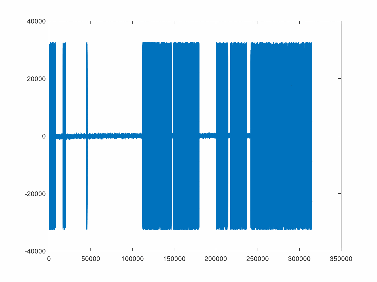

Data corruption with PDM Microphone
I am using a MEMS PDM microphone and reading it in using I2S. The following parameters are set in my I2S and PDM configurations.
hi2s3.Instance = SPI3;
 hi2s3.Init.Mode = I2S_MODE_MASTER_RX;
 hi2s3.Init.Standard = I2S_STANDARD_MSB;
 hi2s3.Init.DataFormat = I2S_DATAFORMAT_24B;
 hi2s3.Init.MCLKOutput = I2S_MCLKOUTPUT_DISABLE;
 hi2s3.Init.AudioFreq = I2S_AUDIOFREQ_48K;
 hi2s3.Init.CPOL = I2S_CPOL_LOW;
 hi2s3.Init.ClockSource = I2S_CLOCK_PLL;
 hi2s3.Init.FullDuplexMode = I2S_FULLDUPLEXMODE_ENABLE;
The PDM2PCM decimation factor is 64. I am sending the data out of the uart at 2Mbaud, but am getting gaps of corrupt values in my data. Is this because I am not sending it fast enough? If so, how could I buffer this better in order to fix this issue?
Thanks for any help, my code is here as well and an image of my plotted audio.

Eleon BORLINI
Feb 19, 2021 1:51 PM UTC
Hi @kcire L.​ ,
If the word rate is 48kHz and the bit depth is 24 bits, you should be able to send a 1.152.000 serial data on a 2MBaud rate.
However, since the audio stream can be a little tricky, to be sure this is not the issue you could check if with a lower word rate or a lower you still get wrong data.
Btw, which is the PDM clock frequency you are feeding the mic? 64x48kHz = 3.072MHz, right?
And can you check the membrane of the MEMS microphone inside the acoustic inlet with a microscope, to be sure it is not damaged?
-Eleon
kcire L.
kcire L.Author
Feb 19, 2021 3:43 PM UTC
I tried it with 16Khz with 64 decimation factor which would be 1.024Mhz clock and I was still getting this error. Is there a bug in my code? I tried two MEMS microphones and had the same result....
Thanks for the responses

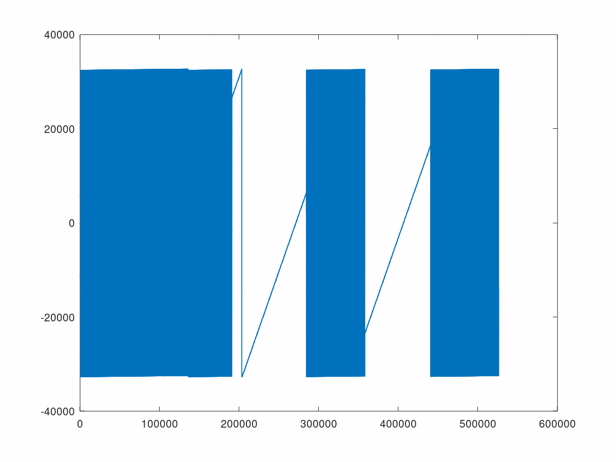

kcire L.
kcire L.Author
Feb 19, 2021 4:12 PM UTC
I did try this with hard coded data of a ramp from 0 to 65535 and this is the result I get... same issue so I don't think it's the microphone... my code must have an error but I can't figure out what it is.
