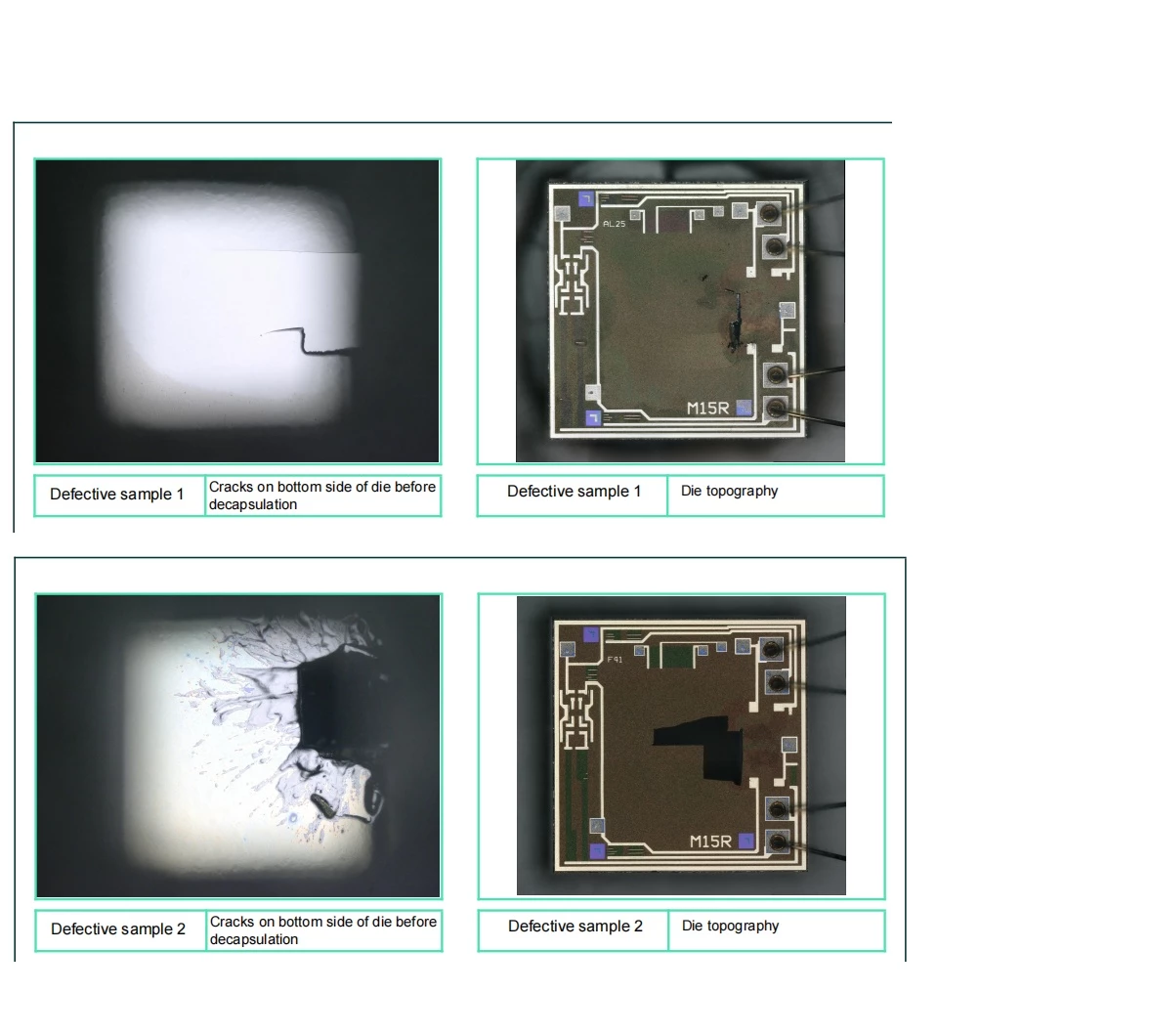

We encountered an issue with the MPXM2053GS sensors: several units showed no output after SMT assembly. Decap analysis revealed that the die in the failed parts was damaged. We would like to understand whether this was caused by mechanical mishandling or other factors, and what measures can be taken to prevent recurrence.
