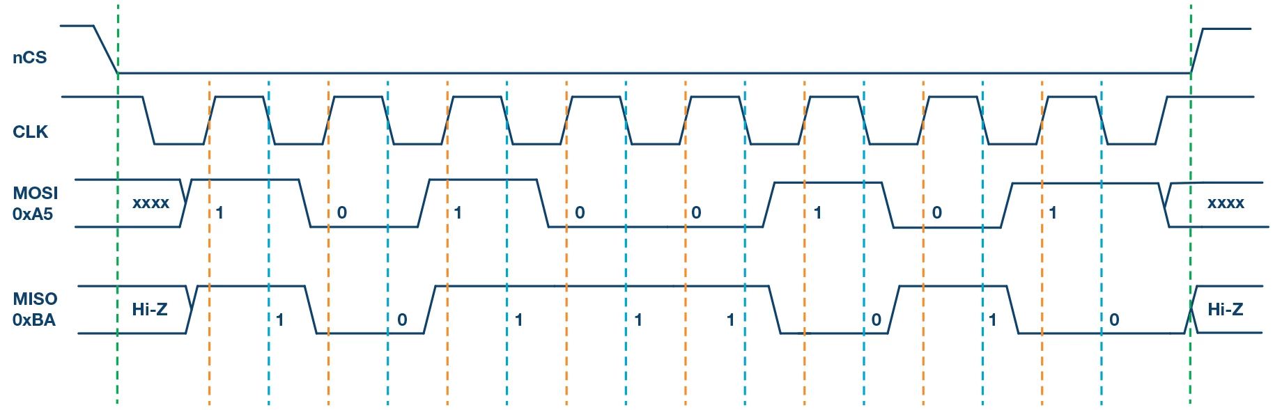

Hi @Community member​ ,
please note that your "Scenario n.1" is very similar to "Scenario n.2" in most cases, since a floating pad voltage value is often close to 0V, mostly depending on the surrounding electrical environment.
The third scenario, i.e. nCS pad transition from Vdd to GND, followed by the clock activation, is the requested one. This is valid in general for the SPI communication, and explicitly for ST sensors, since it is the trigger for the ASIC internal SPI state machine, as suggested by yourself.
Please note that usually ST sensors run in SPI Mode 3, as depicted here below:

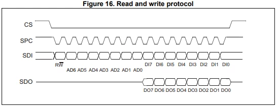

the SPI communication starts after transition high to low of the CS pin, as you can see in the datasheet, p 29.
0693W000004JmQfQAK.pngAre you keeping the CS pin low all time before starting the SPI communication? If no, you correctly have to "toggle" the pin (asserted-deasserted) as already suggested by you.
-Eleon
