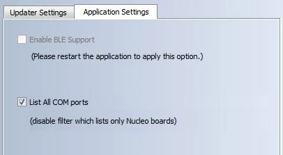

I'm in charge to develop application for vibration monitoring with sensorTile.
but i'm not able to connect the sensor tile with bluetooth on unicleo gui. Despite all my work, update and any thing i can do, unicleo dont want to detect the sensor. I'm try on windows 8.1, the sensor is well appaired, but buton to activate bluetooth is still not accessible.
Thanks for your help
    2 replies
    March 6, 2019
    The BLE support in Unicleo-GUI is not available for Windows 8.1, you would need to use Windows 10.
    david binkowski
    March 6, 2019
    Hy Miroslav
    Thanks for your answer. So its finaly normal that the sensor canot communicate.
    An update of the unicleo manual should be necessary because the 8.1 is writen as compatible....
    My computer will be upgraded soon to W10, i need to be patient
