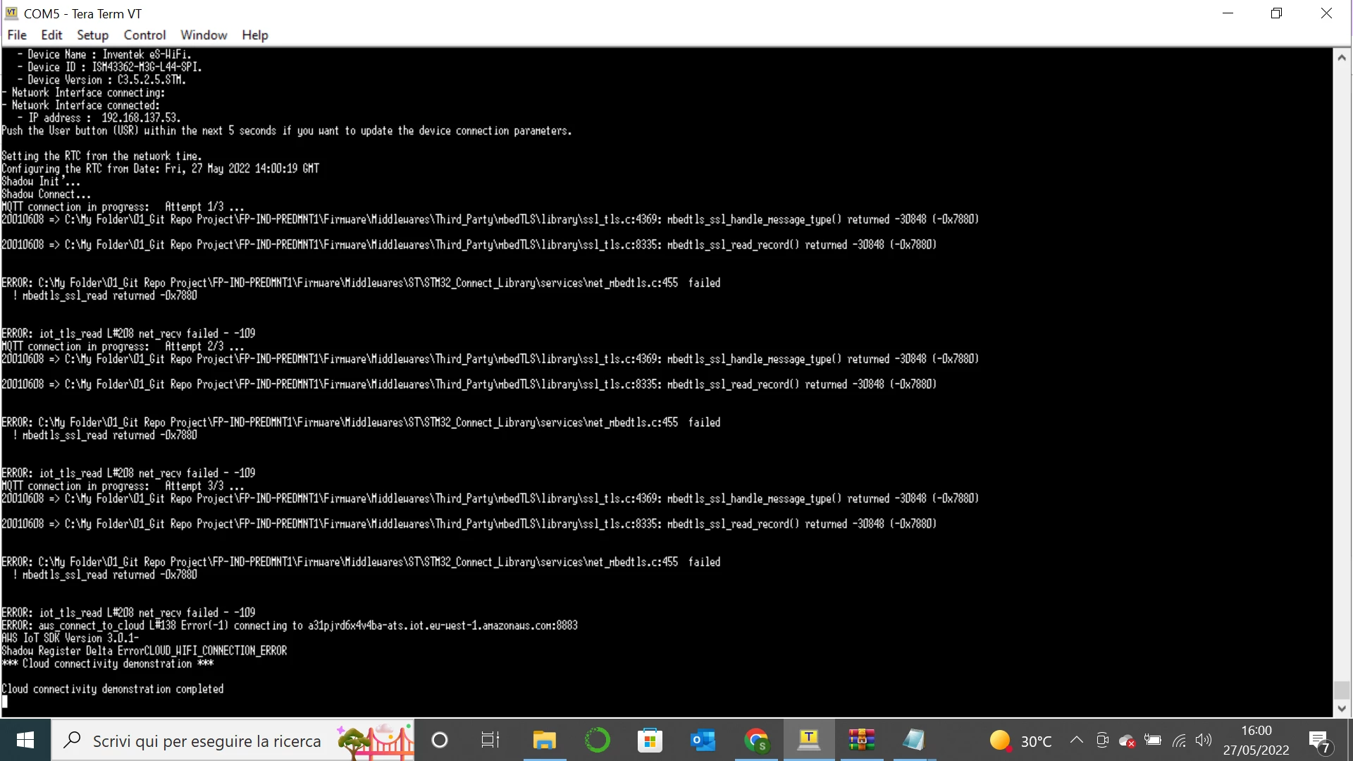

I have the STEVAL-STWINWFV1 Wi-Fi expansion and the board connects to the network correctly.
However, when I try to get the board to connect using TeraTerm according to the instructions described, I get the error below:
Frankly, I have no idea how to fix it, so I really hope you can point me to a solution.

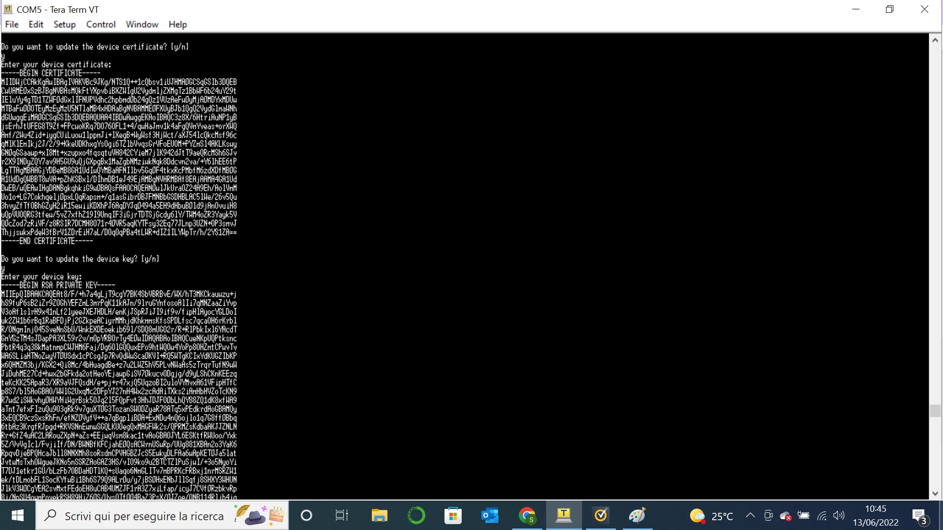

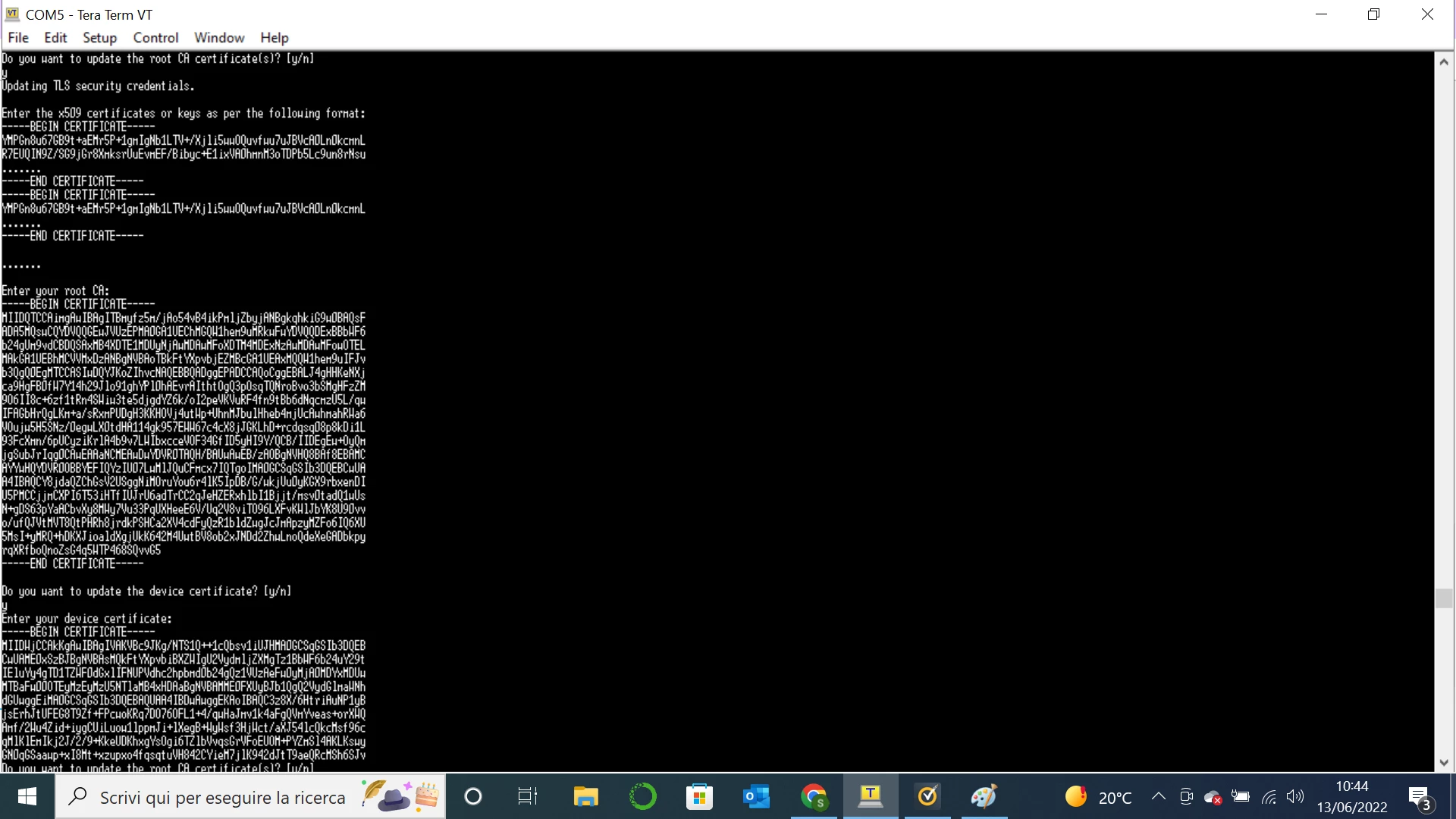

    • FP-AI-PREDMNT1 does not exist. Probably you are referring to FP-IND-PREDMNT1. In our opinion it hasn't uploaded the certificates. In the TeraTerm log you did not press the USR button, as indicated. Try to do it all over again, redoing the whole configuration by pressing USR every time it is requested and show us the complete log.

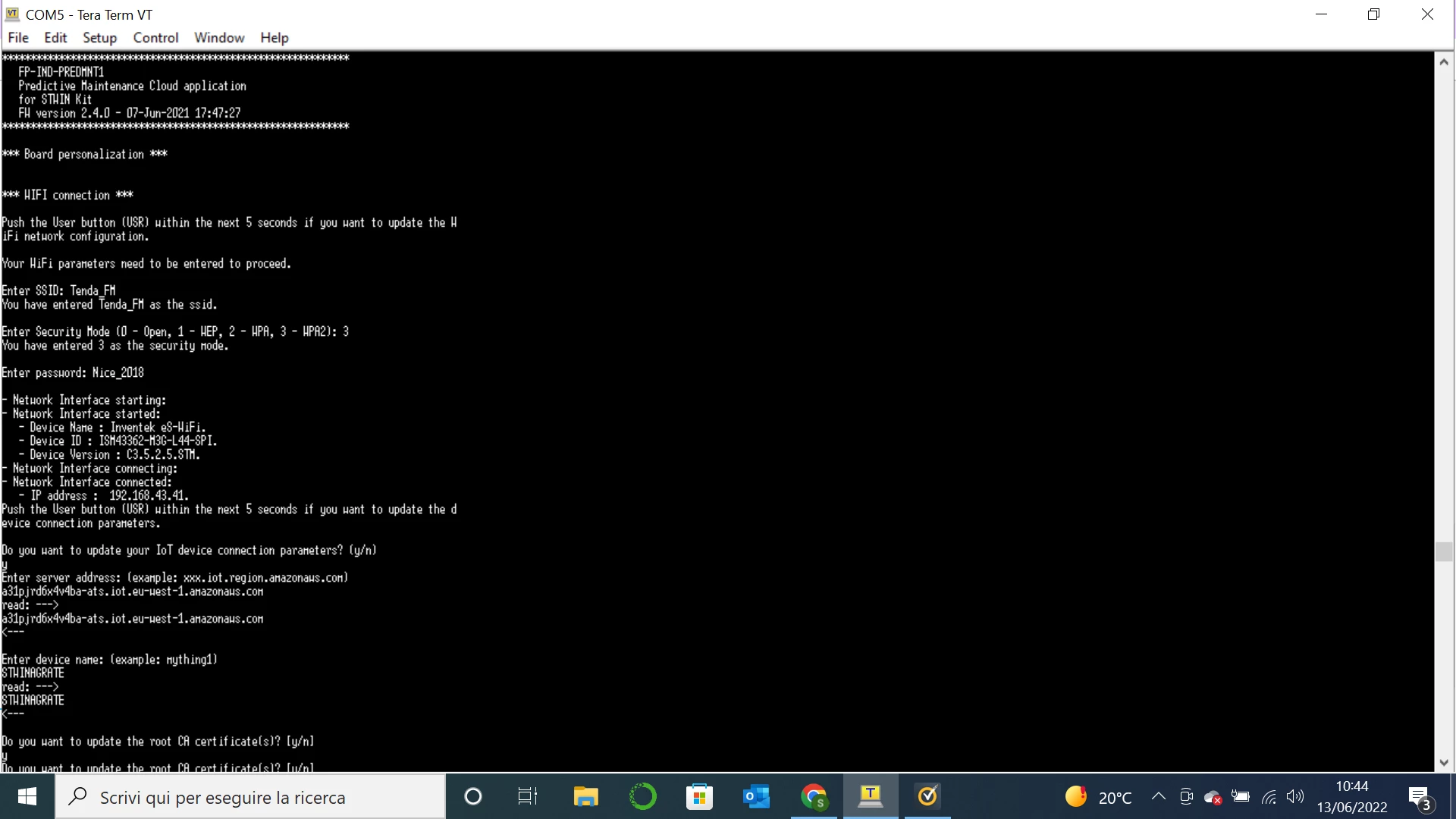

    • Last thing: The network you are connecting to must be 2.4GHz. The module does not support 5GHz wi-fi.

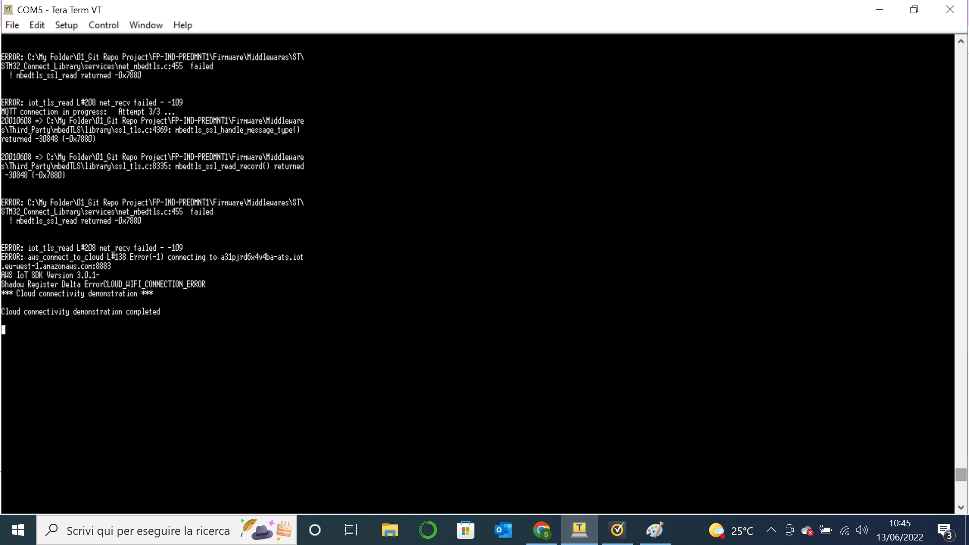

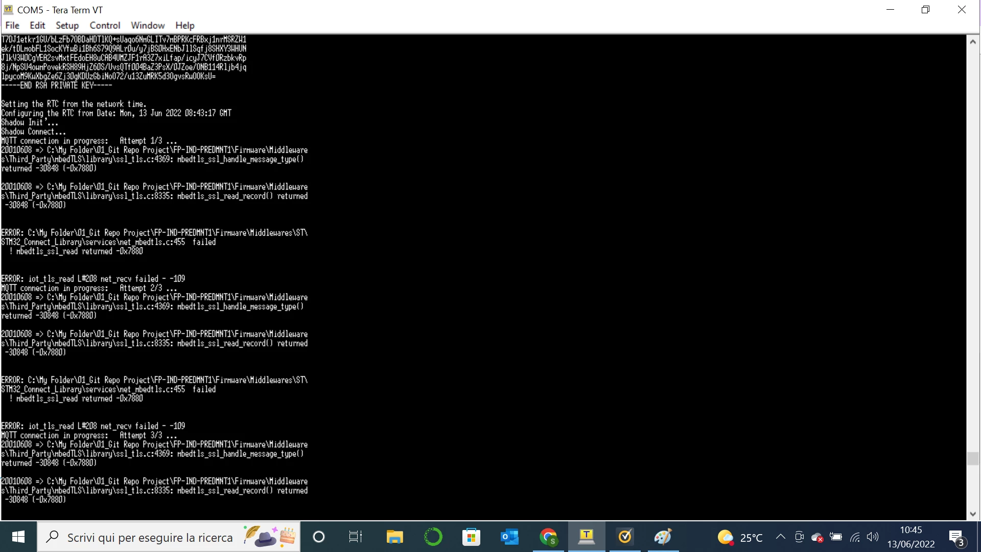

    Clearly I pressed the USR button to insert the certificates, below I report the complete log:
