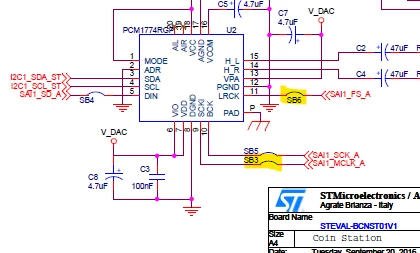

hi am planning to print the pcm buffer which is used in audio loop example but i am not able to configure the pins to print it on swd console or using uart

I have checked internally with our experts on the Bluecoin tool, and if you use the USART1 line you have to modify a little also the hardware (toghether with the FW):
You have first to remove the SAI from the FW, because you will need these physical pins, but the audio out on the jack will be prevented to work
To take the signals you than have to connect to the CoinStation, desolder the SAI signals that are routed to the amplifier and take the USART data from the CN3:
Let me know if the procedure is clear.
-Eleon

i am not clear with the third point i have soldered cn2 pins and added bluecoin station
Eleon BORLINI
April 30, 2021
Hi @Dinakaran Palani​ ,
the CN2 is the SAI connector for the coin board, while the CN3 is for external signal.
-Eleon
