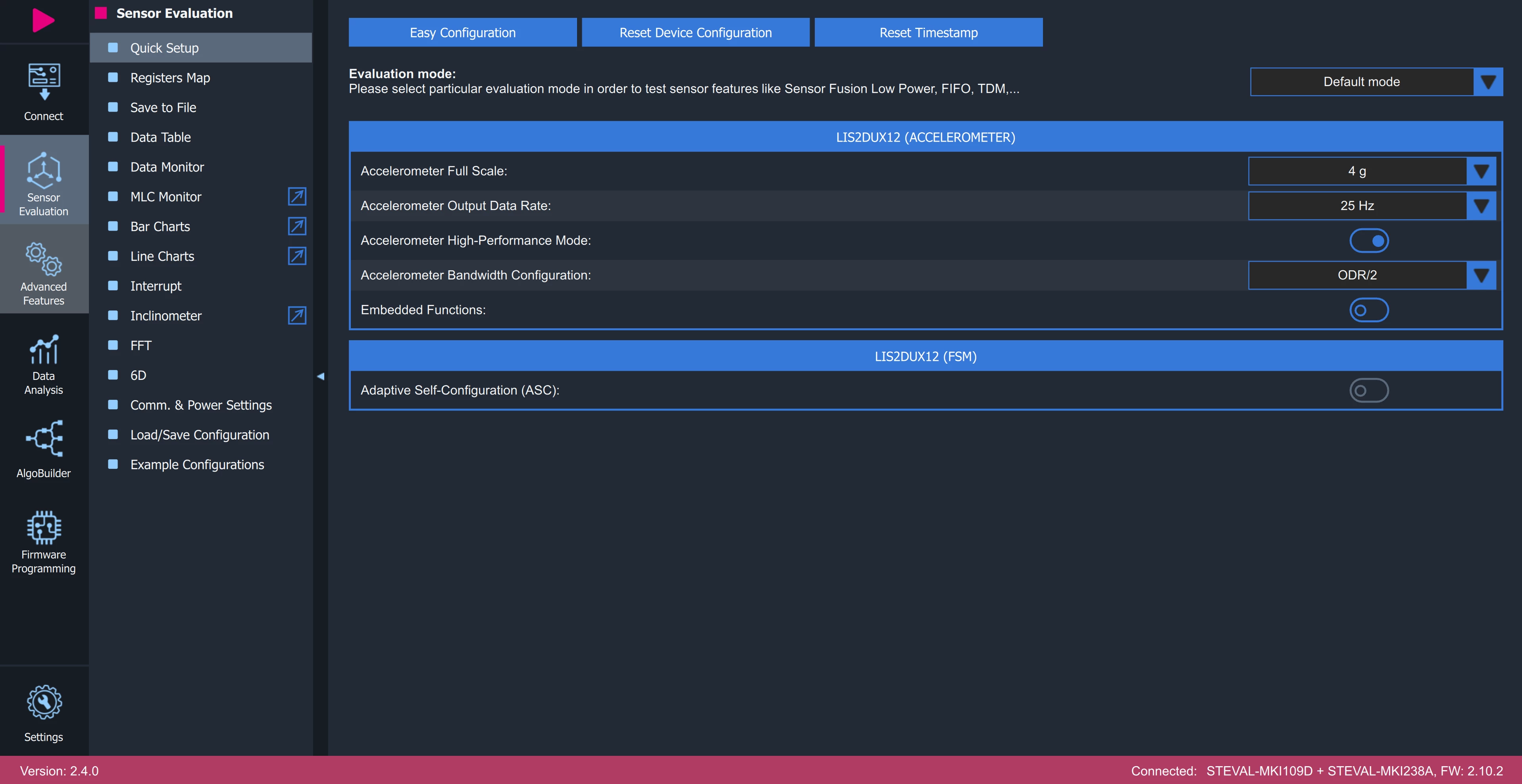

First, I set up the sensor using 'Easy Configuration' and changed the Full Scale to ±4g, the Output Data Rate (ODR) to 25 Hz, enabled High-Performance mode, and set the bandwidth to ODR/2.
Quick setup configuration

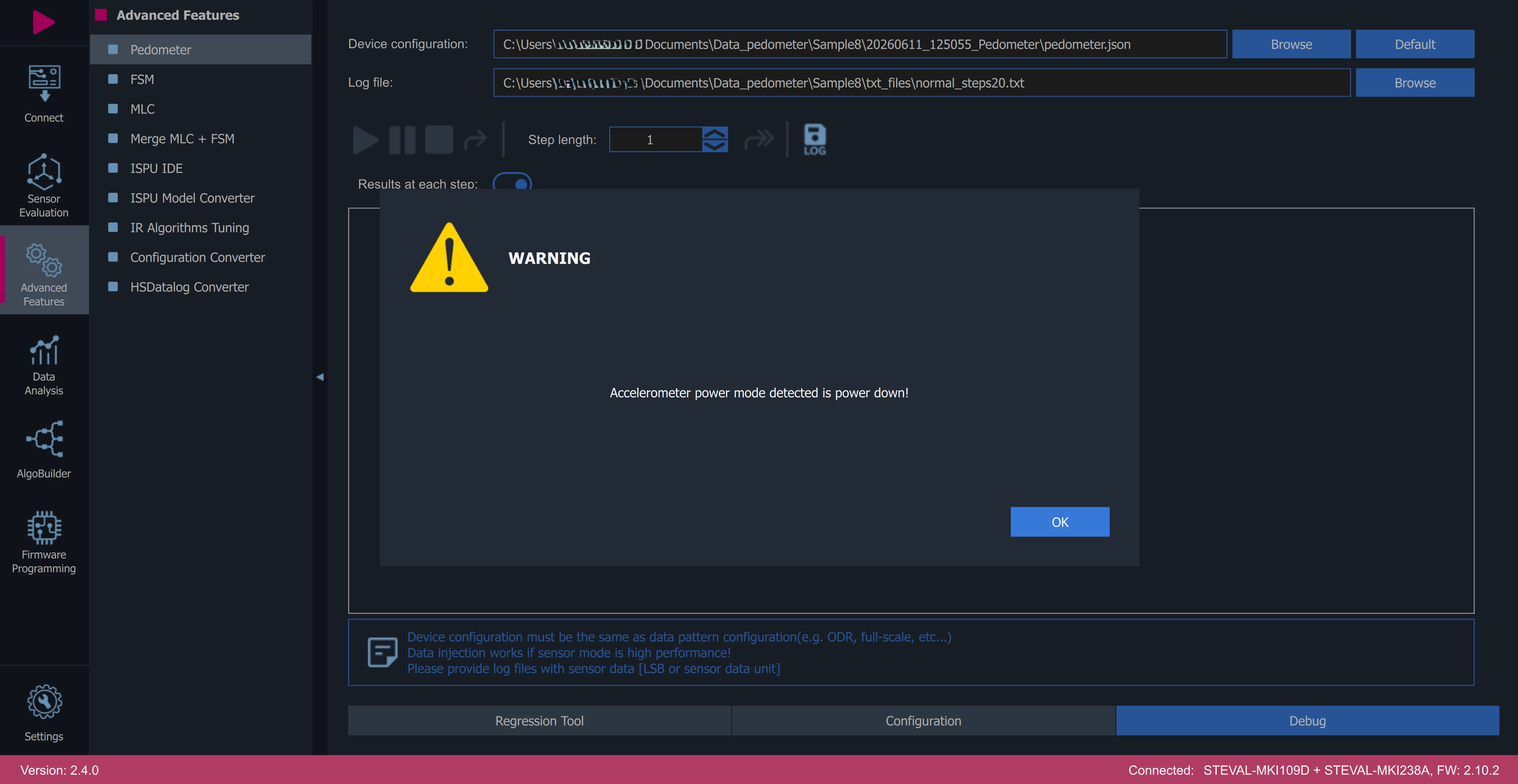

After that, I went to the debug page to test the results. I loaded the pedometer.json configuration and selected the normal_steps20.txt log file. However, the following warning appeared: 'Accelerometer power mode detected is power down!'.
I tried modifying the JSON configuration file to enable high-power mode. Although the warning disappeared, the debug results were still incorrect.

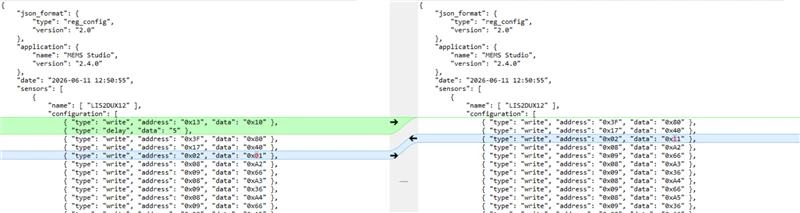

Regression tool provides only set of parameters to optimize pedometer steps detection and the output configuration will not enable pedometer and power accelerometer on. This is why the debug tool is triggering the error you shared. Therefore you will need to add instructions to enable pedometer and power on sensor at the end of your configuration file (see last 4 instructions).
  While reviewing the output file shared, we identified an issue with this specific sensor related to  missing embedded function enable request and related mandatory delay of 5 ms and  following value written for register 0x02 should be "0x01" instead of "0x11".
We are currently working on integrating these fixes into next version of MEMS Studio.
Performing the debug of this fixed configuration on "fast_steps20.txt" you will get 18 steps according to the regression_tool.config file.

Here is the json
