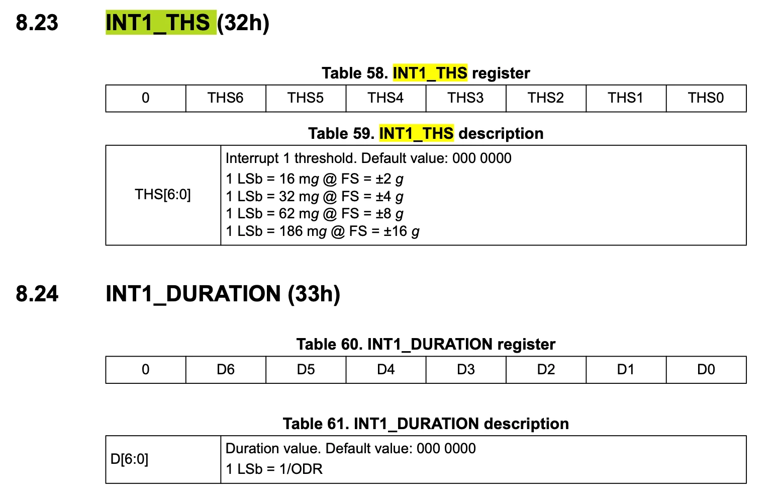

Rajeev Piyare
February 27, 2020
Hi @Eleon BORLINI​ ,
In order to detect events though LIS3DH interrupt pins, two of the main parameters are
  1. Threshold value (INTx_THS)
  2. INTx_DURATION
However, I am having a bit of difficulty in interpreting these values. How does the value for instance 0x10 translates to threshold of 250mg and 0x03 to duration of ~30ms.
This clarification will help me to set these desired parameters accurately for my application.
Thanks
