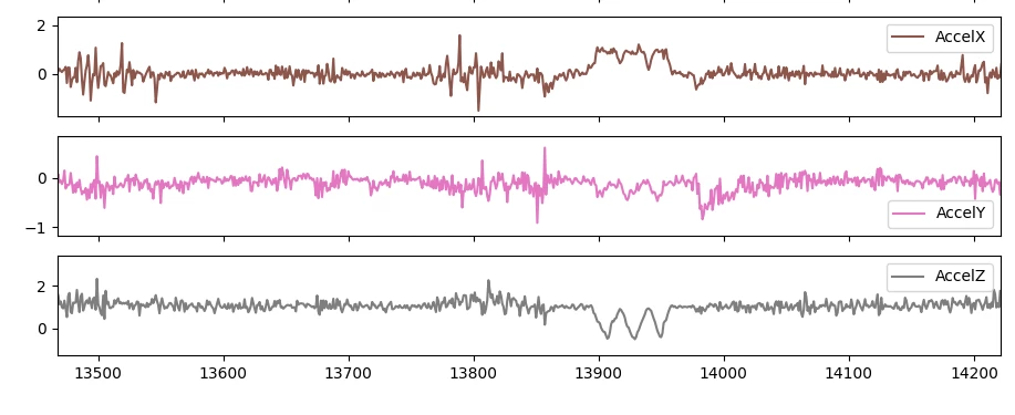

Hi!
I inherited a project and we're seeing strange accelerometer values and I'd like to get a sanity check on my configuration. when Idle and flat, I see 1g on Z, 0g on X and Y. When my device is moving I see peaks on many axes beyond 1g, eg 2.5 on X or Z, and it does not seem real. Here is downsampled data from a log file. X (brown) goes from +1.5g to -1.5g, Z (gray) is over 2.3g. I am not expecting such numbers during a short banked turn at ~15 mph
This is my init. I'm expecting 104Hz data rate, 4g acc scale, 1000dps gyrp scale

Federica Bossi
Jul 29, 2025 7:39 AM UTC
Hi @ms360 ,
We don't expect such values. Could you try repeating the test by implementing our examples available on GitHub? Just to exclude any issues related to your code.
ms360Author
Jul 29, 2025 2:31 PM UTC
Thanks Federica. Bench testing always looks good. I get about 1G magnitude between the 3 axes. Even motion FX shows good rotation data on the bench.
Field data is always where we see the weird values. Our logging is only at 4Hz due to space constrictions.
I'll compare your github examples against what we have, and go from there.
Is there any reason a sampling rate of 104 hz is risky? The examples have lower sample rates.
Is there any documentation of sampling rate minimums to use with Motion FX?
ms360Author
Jul 30, 2025 2:44 PM UTC
@Federica Bossi I am noticing some small and large differences from your example code.
I'm going to add batch rates, stream mode, disable I3C and pull out sensor hub and the extra registers and do some field testing.
The code I've inherited does not
  • disable i3c
  • different sample rates (slower)
  • set batch rate
  • set stream mode
The code I have inherited does
  • use LSM6DSOHub / sensor hub
  • set extra registers
