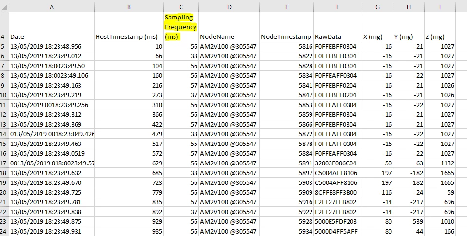

May 13, 2019
0690X000008BfeNQAS.pngHello Eleon, thank you for your help
I found all the data your show in your answer, and this remains a mystery to me because, since the ODR is actually well set to 100.4f, my samling data still represents 50ms sampling period.
I collect data with Android APP and Unicleo and it's the same sampling period !!!
I have taken a screenshot of my CSV values , I will be very grateful to lighting me. Thanks a new time for your help
