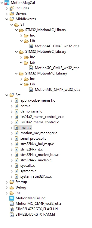

Hi Everyone.

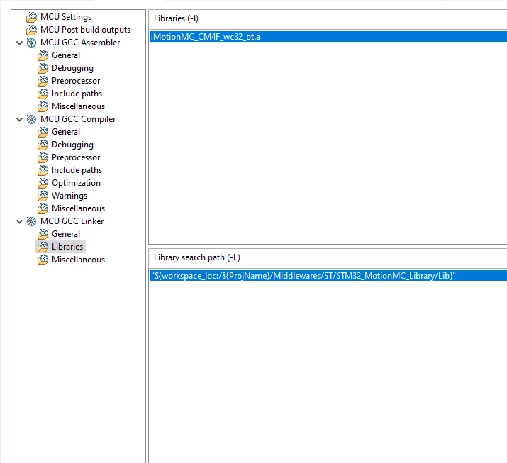

I have created a STM32CubeIDE project for the L476 Nucleo.
I'm having huge issues trying to link the "MotionMC_CM4F_wc32_ot.a" library into my project.
The images are 1) of my file tree structure, and 2) the statement entered into the linker settings
trying to copy exactly as possible from the STM32 eCompass example.

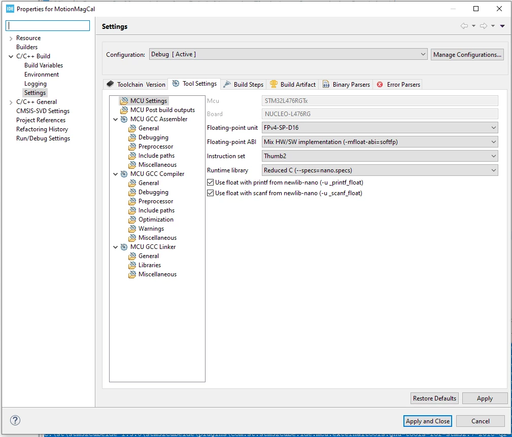

    The libraries in MEMS1 package are compiled with softfp compiler option. In STM32CubeIDE you have to select Mix HW/SW implementation in C/C++ Build -> Settings -> Tool Settings -> Floating-Point ABI.

    Hi Miroslav, thanks for responding.
    I completed the settings as you suggested, and included an image, but I'm getting even more errors this time.

    In the image it shows the two check boxes at the bottom selected, but I've tried all combinations.

    Hi Miroslav.
    I think you mean to double check I made the correct changes. I went back and compared all changes
    I made to be the same as the settings in the MEMS1 example project.
    After that I had the idea of cleaning the project and deleting the debug directory. I rebuilt the project and it worked.
    Selecting "Mix HW/SW implementation" in C/C++ Build -> Settings -> Tool Settings -> Floating-Point ABI
    fixed my issue.
    cheers.
