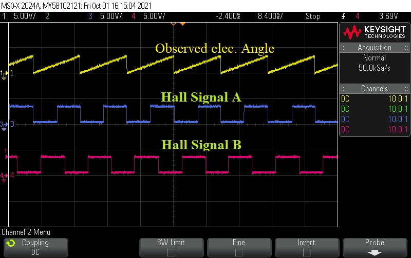

Do you mean to measure electrical angle from the (observer+PLL ) and compare with Hall Signal (Ha) to see both are aligned together? If not check the displacement angle??

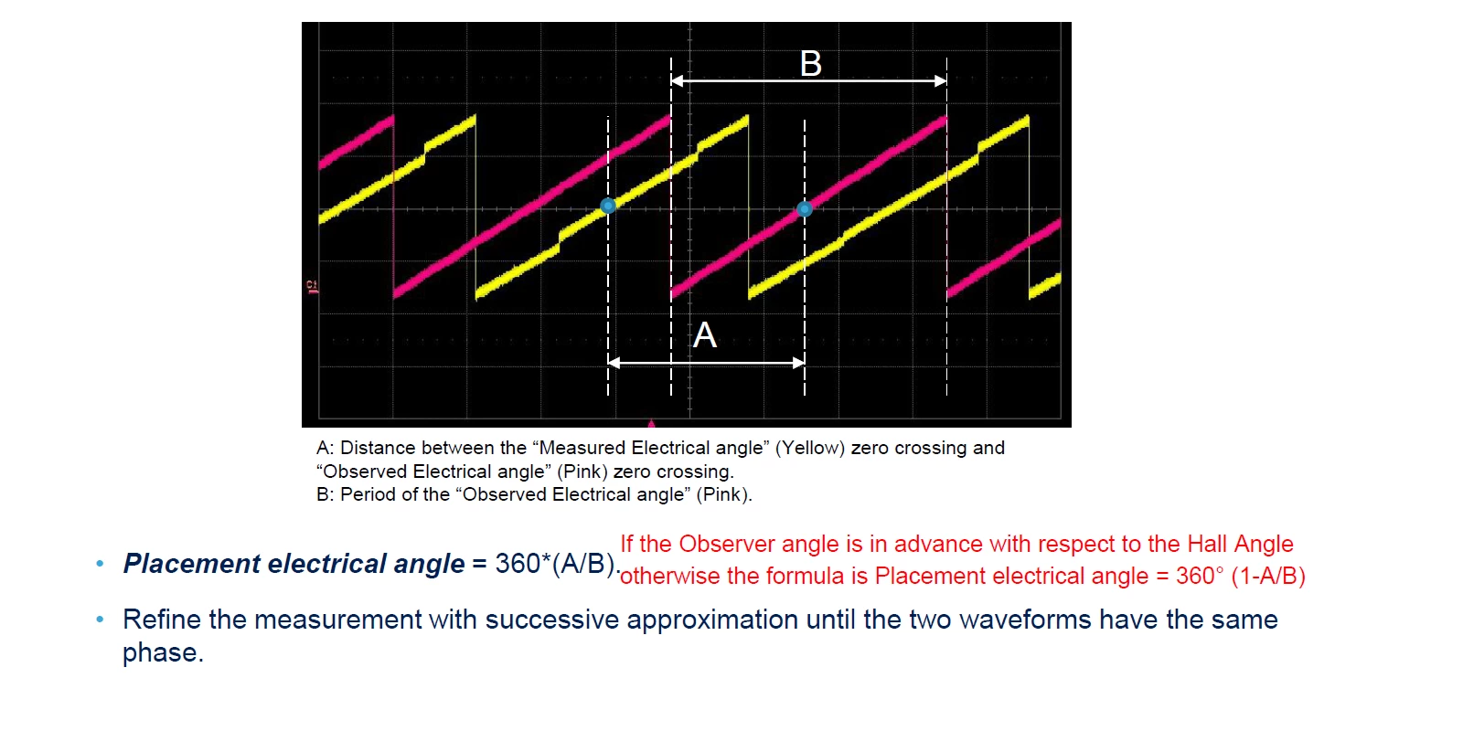

The idea is to print the Observed elec angle coming from the STO-PLL algo, and the measured electrical angle coming from the Hall sensor auxiliary. You should see the 2 sawtooth . The hall signals plot is not helpful for Hall sensor tuning.

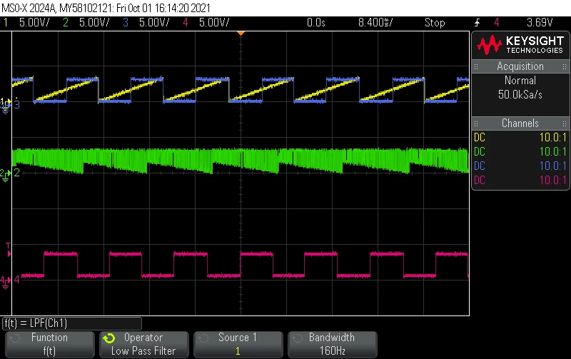

I use 5.4.7 version. Yellow curve is the observed elec. angle and green is the measured electrical angle, However it is difficult to observe the elec angle measured by Hall sensor.

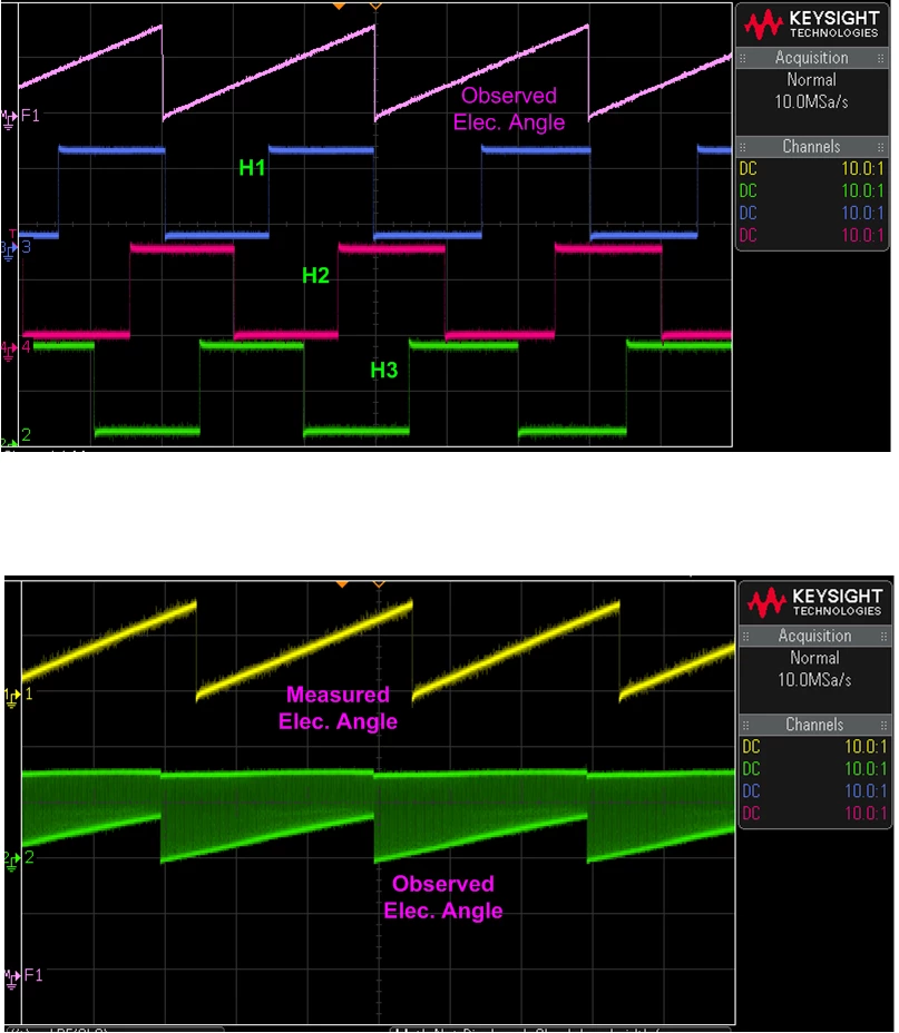

0693W00000FBAwmQAH.pngThis is the curve you should observe.
On 5.4.7 it can be observed with the DAC only.
From your picture, the first thing is that your both curves are opposite, This means that your Hall sensors connexion are not Ok.
The second point is that your observed angle go back to 0, could you print your three hall sensors signal ? I wonder if the three sensors toggle correctly.

Since from the previous result, both measured and observed elec. angle are opposite. I changed Hall signal 2 and 3, now the measured and observed elec. angle are in right direction. I measured in both positive and negative direction to see the difference.
in DAC channels, i think Channel 2 is damaged. The signal is not ideal.

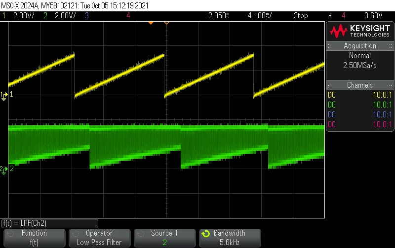

I used 5.Y.2 but still the signal is same. I hope the pin (PA5) in CN10 might get damaged.

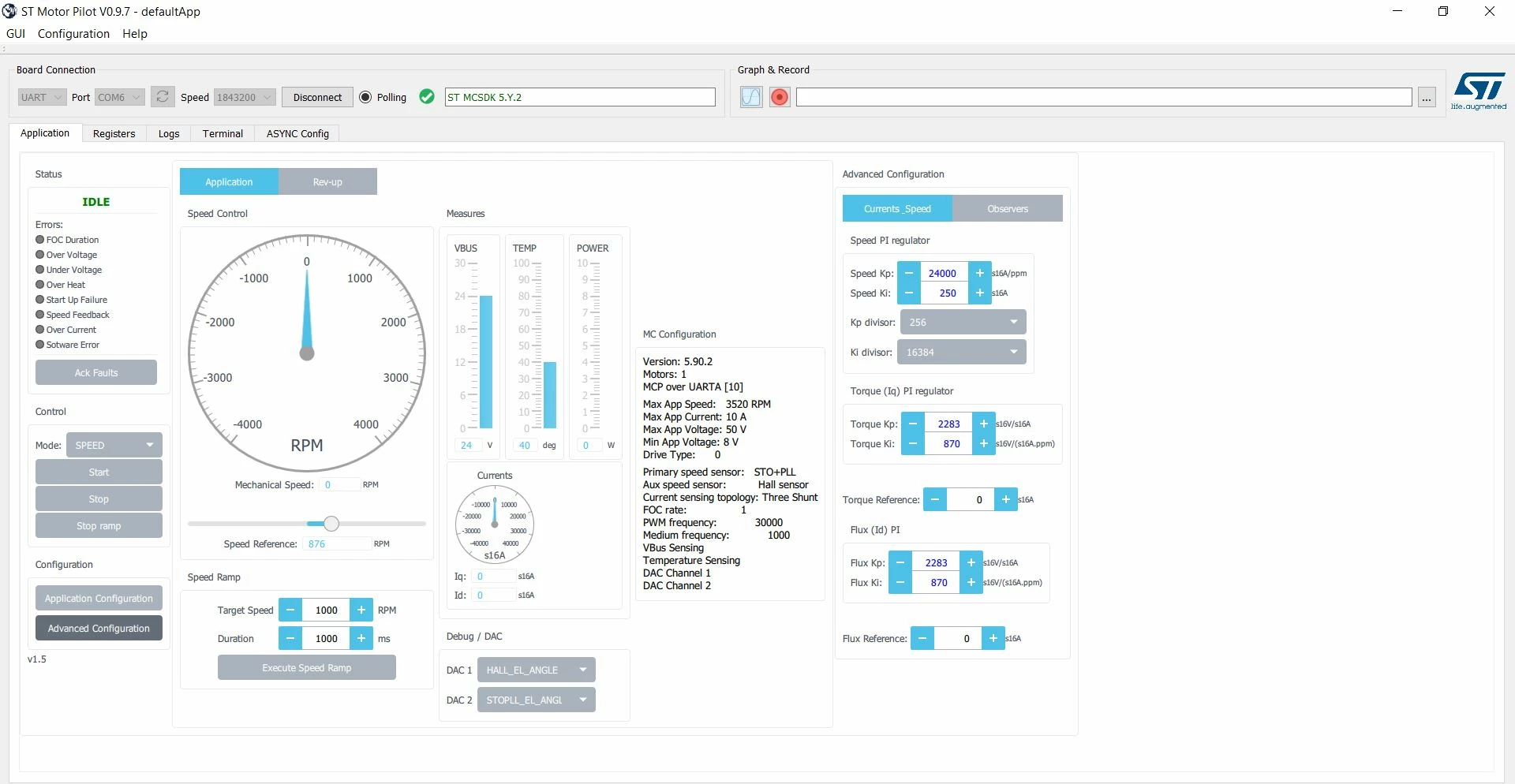

Sorry, I was not clear enough. The purpose of switching to 5.Y.2 and the new Pilot is to be able to see these angles inside the mPilot, and not with the DAC output and the scope.
If you look at the top right of your mPilot screen shot, you have two buttons in the box "Graph and Record". If you click on the graph button, it will open a new window. If you right click inside this window, you will be able to select the signals you want to plot. (HALL_EL_ANGLE & STOPLL_EL_ANGLE)
With the new communication protocol we increased the communication speed so much that we are able now to dump FOC variables at PWM frequency.
It will at least remove your concern about the DAC output pin.
Before doing this, could you zoom in your oscilloscope to see at which frequency the HALL angle switch to 0.

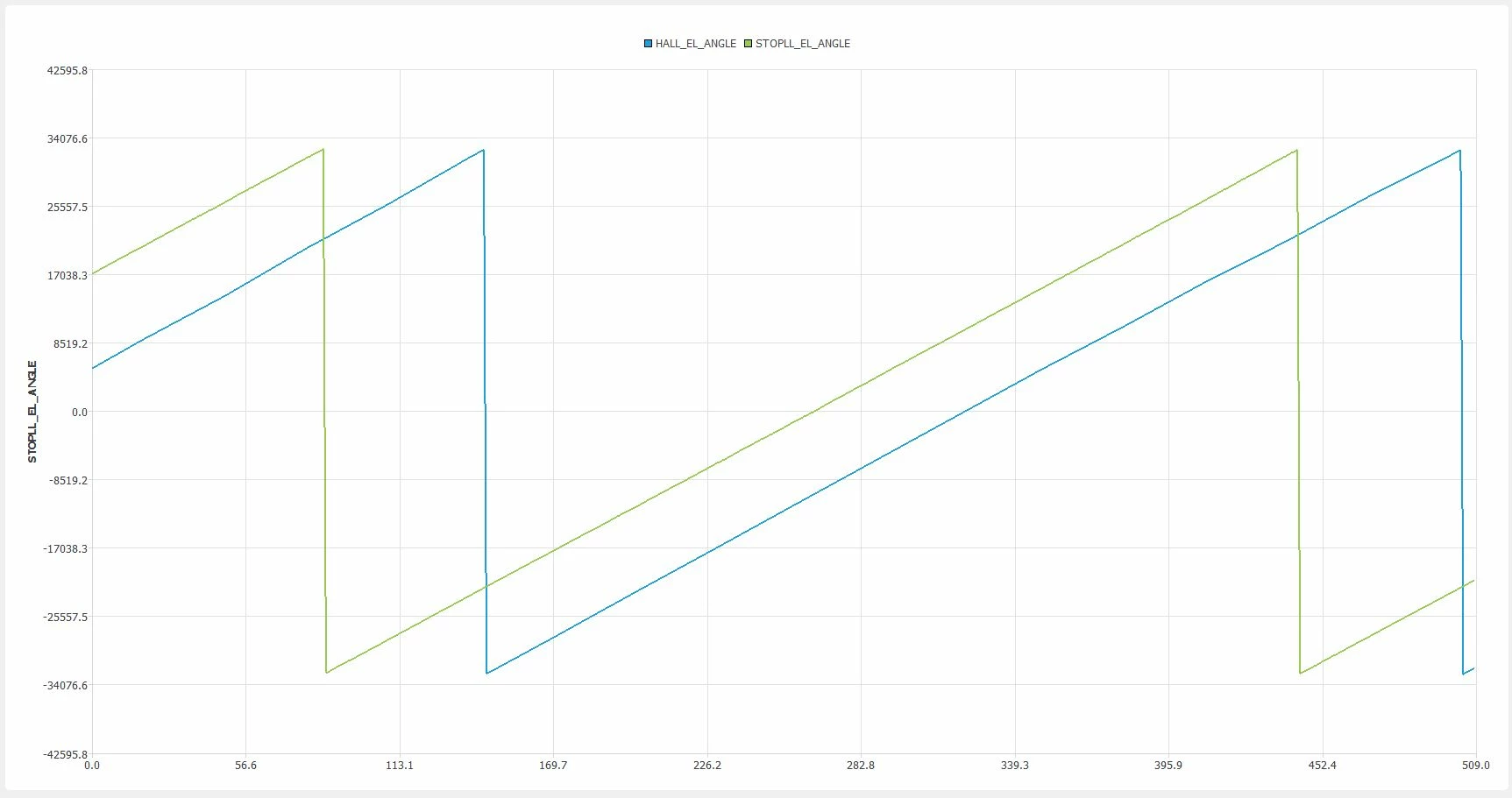

I tried measuring Estimated and Hall Elec. angles using Graph in Motor Pilot. But cannot increase the no. of cycles? Can I able to change the x-axis scaling? Because its difficult to calculate placement electrical angle using this reading.
cedric H
October 6, 2021
Hello @Community member​ ,
Good progress, your plot is pretty nice, I think you have already something functional with Hall sensors as primary sensor, even if it is not optimal.
We are thinking of an application on top of mPilot to automatize all this process.
From what I see, the angle computing by the Hall sensor algo is Ok. so the Issue with your oscilloscope plot is probably due to a signal conflict on your board with DAC output.
Anyway, the shift can be tuned by dichotomy, the variable to change is HALL_M1->PhaseShift you can change it while your motor is spinning.

So if we change the placement electrical angle, the measured angle and STO_PLL_angle should superimpose?? If yes, then need to use the same angle in the project where Hall Sensor as primary sensor ??
cedric H
October 7, 2021
Yes, and yes, the purpose of having both angles plot at the same time is to compute the placement electrical angle to have both curves superimposed. This angle is actually a motor characteristic so it should be set for all the project using this motor, without distinction between primary or auxiliary sensor. The usage of auxiliary sensor is just a trick to be able to compute this placement angle.
I hope it is clear now.
