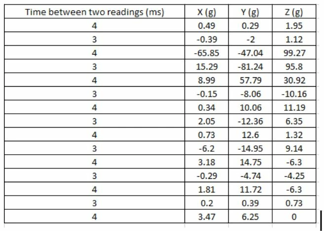

Can't reach 1000 Hz output data rate for H3LIS331DL Accelerometer sensor
As the datasheet of H3LIS331DL has a 1000 Hz output data rate which means 1 reading every 1 millisecond, and that what is required in my project, I am using an I2C connection and having the period between two readings 3 to 4 milliseconds, the code is as follow :

The Output Result:
0693W00000QKOhhQAH.jpgcould you please help me to have 1 reading every 1 milisecond.
Thanks

    KnarfB
    July 4, 2022
    The serial port baud rate is a limiting factor. Calculate how many chars/s you can print.
    hth

    AGHAZ.1Author
    July 5, 2022
    Thank you for your reply. Could you please tell me how to do it :grinning_face_with_sweat: , and is there any way to overcome the baud rate limitation so the sensor output data rate can reach 1 kHz,
    I decreased the baud rate, and the interval between two readings increased, but when I increased the baud rate, the interval would stay3 to 4 even when the baud rate on 2000000.
