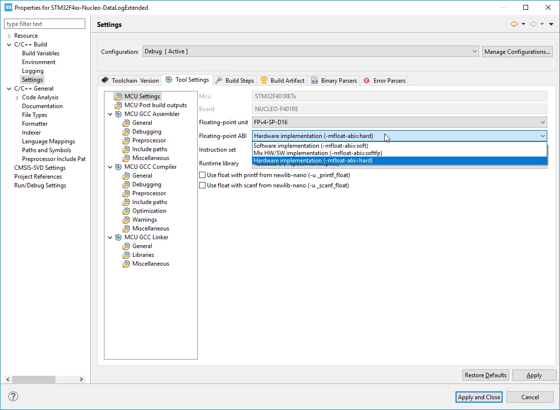

    Another question, do you have MotionMC library built with "-mfloat-abi=hard"?

    Eleon BORLINI
    July 9, 2020
    Hi Min-Ching Ho, of course the libraries "as-they-are" shall run on STM32 MCU. However, regarding your question "Another question, do you have MotionMC library built with "-mfloat-abi=hard"?" , the X-CUBE-MEMS1 package can be compiled to run on all ARM-based MCUs and with the soft, but since the the release of STM proprietary libraries is subject to signature of a License User Agreement (LUA), you should contact an STMicroelectronics sales office and representatives for further information.
    Please also check this discussion if it can be of your help --> https://community.st.com/s/question/0D50X0000Bvk9coSQA/source-code-for-stcoms-xcubemems1-available
    "Go to project properties and try to find the settings there,
    I don't have Attolic TrueStudio but in STM32CubeIDE it looks like in the attached screenshot.
    Regards
