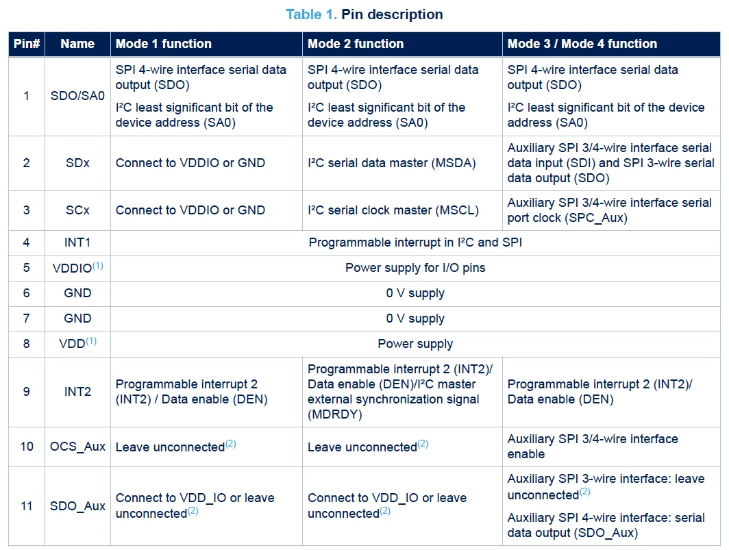

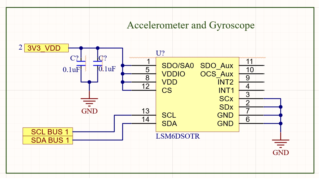

Can I leave INT pins unconnected for the LSM6DSO accelerometer and gyro sensor?
Can I leave INT pins (INT1 and INT2) unconnected for the LSM6DSO accelerometer and gyro sensor?

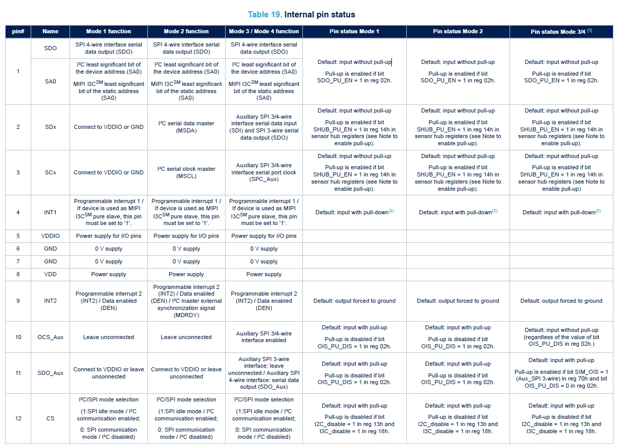

In the "internal pin status" table It says that the INT2 pin is forced to connect to ground. I use neither INT1 nor INT2 in my project.

    Hi @Batuhan A.​ ,
    if you don't need those two pins you can leave them unconnected, there should not be any problem with that.
    hope this helps
    Niccolò
