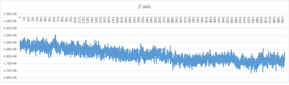

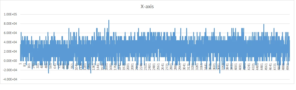

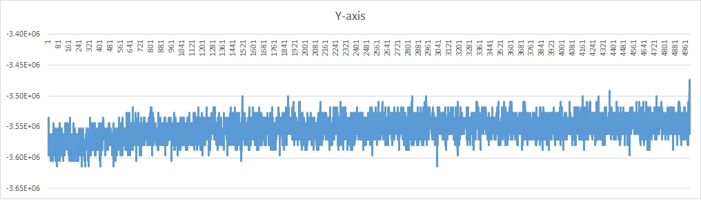

I am using LSM6DS3. I got very strange values of gyroscope and accelerometer. I save some data of gyroscope at static position and figures of gyroscope data at static position is attached. Does LSM6DS3 needs calibration? Or we don't need to celebrate the LSMDS3? It is very difficult to arrange rotation table by calibration and sometime impossible?

    Hi @MHass.1​ , regarding the y axis of your graphs, are the values in "dps" units? And do they refer to the gyroscope acquisition? Assuming that the master-slave communication is OK, I would suggest you to check if you properly configured the LSM6DS3 device and if you are well decoding the data, by checking the C code examples on Github repository at this link, for example the lsm6ds3_read_data_polling.c file. Regards
