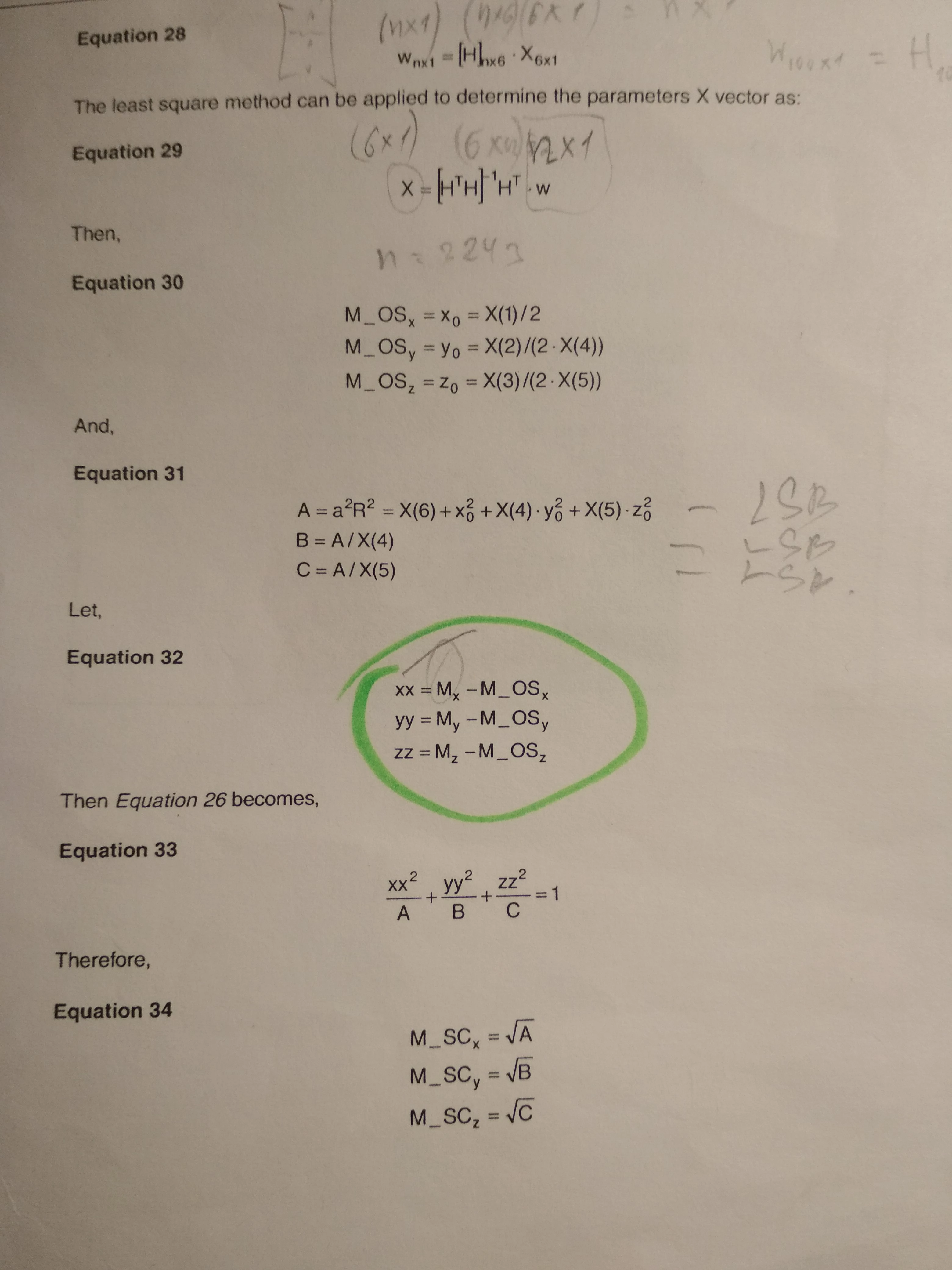

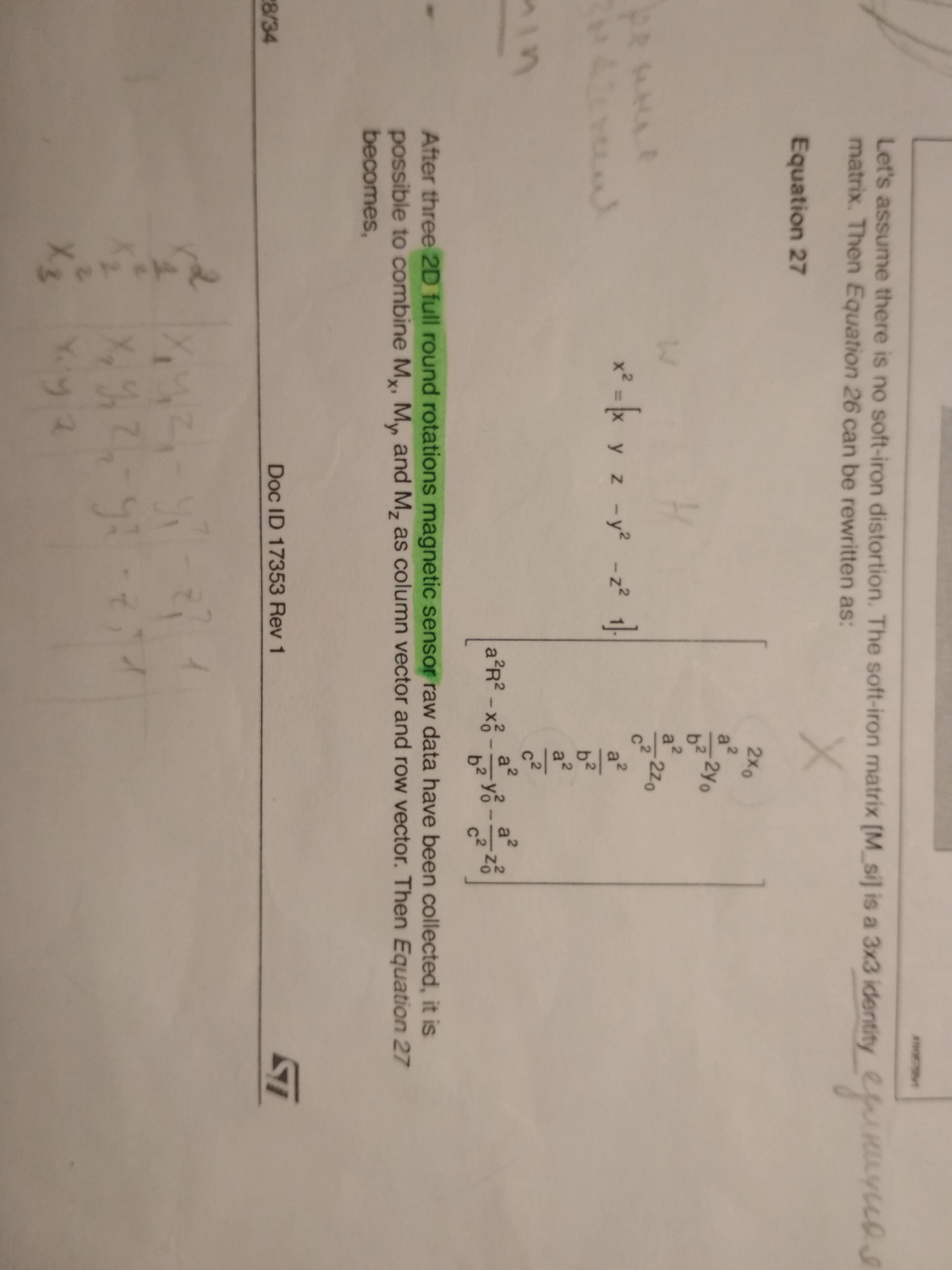

Dear friends, help me please solve the problem that I encountered during the calibration of the LSM303 DLHC magnetometer. I use the technical documentation stm32 AN3192 for calibration. After rotation of the sensor along each axis and data collection, correction factors for displacement and normalization are calculated. Given these coefficients, I should get a normalized sphere with a radius of 1. However, this does not happen. After that, I separately display the calculated values ​​of the calibration coefficients. Can elements A, B, C be negative values?
Tell me what can be caused by their negative values?

    Hi @ABogd.1​ , they should not be negative because they define a sphere in space. Can you share the data you acquired? Did you already check the Motion MC library code of the X-CUBE-MEMS1 function pack, for the magnetometer calibration? Regards
